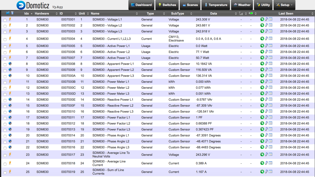

Hello.
Maybe will be useful for somebody.
https://github.com/MFxMF/SDM630-Modbus
In total are 88 parameters mapped.
- screen1.png (390.54 KiB) Viewed 13959 times

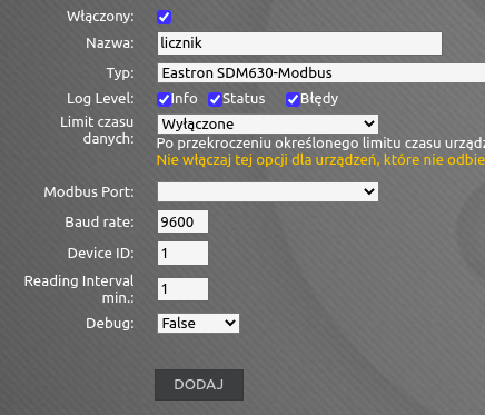

hi
I have DOMOTICZ2021.1 (build 13360) and SDM 630 modbus V2
I have a problem with starting the plugin
I have no choice of COM port
i installed: pyserial, minimalmodbus
- sdm.png (91.54 KiB) Viewed 8393 times
kaziormirek
- Posts: 5
- Joined: Tuesday 28 May 2019 9:06
- Location: Polska, Lubliniec
Re: Python plugin: Eastron SDM630-Modbus V2
i solved my problem
in /boot/config.txt
add in last line enable_uart=1
[all]
#dtoverlay=vc4-fkms-v3d
enable_uart=1
