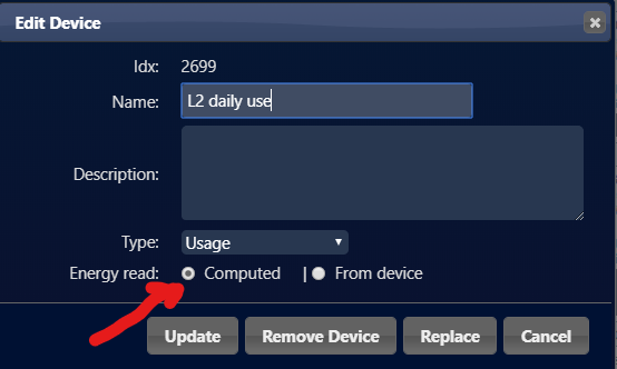

As said, you can create a virtual "Electricity" sensor for each phase. (Electric (Instant + Counter)).
Create the device and in the "Utility" tab you can edit this device as below:
Click the "Radio" button for Energy read as "Computed".
It will give you a sensor as:
The next step is to create a script (e.g. dzVents) that pushes the Current Watts per phase to the newly created sensor.
The daily usage is calculated (See after: Today:) and you can replace the "old" Usage sensor with this one.

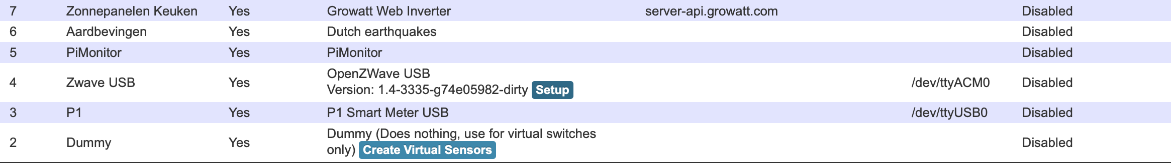

What should I fill in at devices
devices =
1168, -- change to id or 'name' of your L1 device. Only one device or the script will explode !
Is this the P1 Smartmeter Device with IDX 3 ? or IDX 4 (P1) Power
Thanks for the dzVents script.
devices =

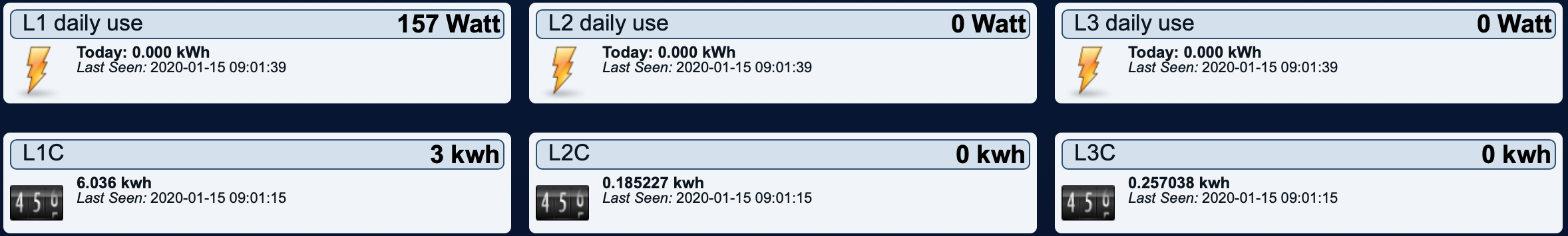

Hi Waaren,
I've been testing this script for a few days.
Device L1C, L2C and L3C works excellent.
I can't set the devices to zero in between.
I only use the script L1Offset which I change because I want to monitor the usage per day.
Is it also possible to create a "daily use in Kwh" of L1,L2 and L3 script?

Stop the script for a moment, delete the device and recreate it. Adjust the offset value in the script and start the script again. After a day or so you will also see a calculated day usage.Knibor wrote: Tuesday 14 January 2020 8:21 Device L1C, L2C and L3C works excellent. I can't set the devices to zero in between.

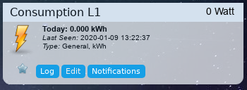

Yesterday I implemented the new script with the daily use.
Actual use in Watts works perfect, but I have no value in used "kWh Today"

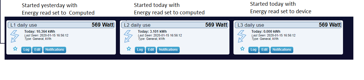

Did you change the Energy read: method as described by @FireWizard ?Knibor wrote: Wednesday 15 January 2020 9:17 Actual use in Watts works perfect, but I have no value in used "kWh Today"
Knibor
- Posts: 112
- Joined: Sunday 20 May 2018 12:56
- Domoticz version: Stable
Re: Smart Meter P1 actual usage Fase1, Fase2, Fase3 to Daily total KW
Yes, the radio button is marked as Computed.
