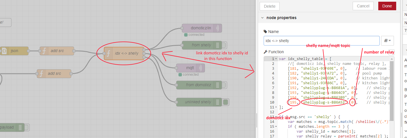

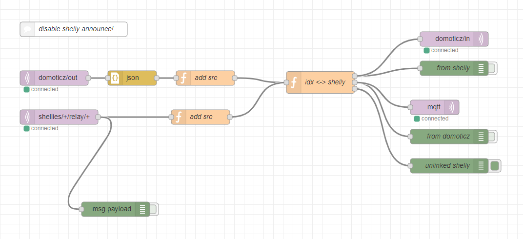

I created a small Node-RED flow to integrate Shelly switches to domoticz.
For a new shelly you just need to modify the idx <-> shelly table in Node-RED and add a new virtual switch in domoticz.

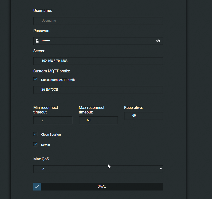

2. e. Connect to your MQTT broker (under advanced - developer settings tab, just server and credentials needed)

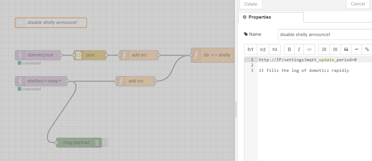

2. f. Disable periodic annoucement of the Shelly to prevent log flooding by calling http://IP/settings?mqtt_update_period=0

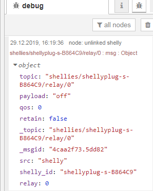

4. In domoticz find the new device IDX under devices and note it.
5. In Node-RED look in the debug log to find the shelly_id and relay.
6. In Node-RED add a new line to the idx <-> shelly function with idx, shelly_id, relay (and remove the sample with idx 193)
7. In Node-RED click deploy
Flow:

You only need node-red and mqtt, plus 1 line of code for each relay in node-red to link domoticz and shelly together ;) no extra plugin needed.
I attached a picture where the linking between domoticz idx and shelly id has to be placed.

I don't use any custom settings on the shellies. I just add the MQTT server. I don't know what happens with the MQTT prefix.
You can check the settings by calling http://IP/settings - replace IP with your shelly IP. If you attach a query like ?mqtt_update_period=0 you change that value.
You can leave the value at default, but it might flood the domoticz logs, because it sends a packet each 30 seconds by default. For power measurement this might be ok.

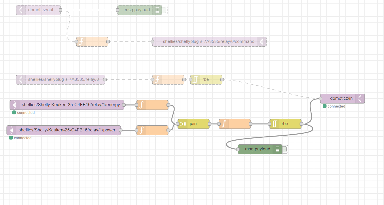

just in case this is still an open point, this is my flow to report energy back from Shelly Plug S (Shelly 1 does NOT report energy back) into an 'energy (instant and counter)' device.
of course you need to adjust to your values.

thomasbaetge wrote: Friday 15 May 2020 15:39 Hi,
[{"id":"fa9bf872.435f98","type":"tab","label":"Shelly plug 2 (Lavalampe)","disabled":false,"info":"192.168.2.55\n"},{"id":"44aab089.dd333","type":"mqtt in","z":"fa9bf872.435f98","name":"","topic":"domoticz/out","qos":"0","datatype":"json","broker":"f80d8629.7db0e8","x":130,"y":40,"wires":[["7784681c.b96d18","e59b032a.2d49c"]]},{"id":"84bb2e75.8fb7d","type":"mqtt out","z":"fa9bf872.435f98","name":"","topic":"shellies/shellyplug-s-7A3535/relay/0/command","qos":"0","retain":"false","broker":"f80d8629.7db0e8","x":670,"y":140,"wires":[]},{"id":"4ae37916.9a2c08","type":"mqtt in","z":"fa9bf872.435f98","name":"","topic":"shellies/shellyplug-s-7A3535/relay/0","qos":"2","datatype":"auto","broker":"f80d8629.7db0e8","x":200,"y":260,"wires":[["c71ef1e6.3c1af"]]},{"id":"316903c5.50e28c","type":"mqtt in","z":"fa9bf872.435f98","name":"","topic":"shellies/shellyplug-s-7A3535/relay/0/power","qos":"2","datatype":"json","broker":"f80d8629.7db0e8","x":190,"y":420,"wires":[["3a5d8fe6.aee38"]]},{"id":"48f52fc1.65a8b","type":"debug","z":"fa9bf872.435f98","name":"","active":false,"tosidebar":true,"console":false,"tostatus":false,"complete":"false","x":910,"y":500,"wires":[]},{"id":"7784681c.b96d18","type":"function","z":"fa9bf872.435f98","name":"","func":"if(msg.payload.id == \"00014165\"){\n    if (msg.payload.nvalue == 1){\n        msg.payload = \"on\";\n    } else {\n        msg.payload = \"off\";\n    }\n    \n}\nreturn msg;","outputs":1,"noerr":0,"x":300,"y":140,"wires":[["84bb2e75.8fb7d"]]},{"id":"d184740e.5b1018","type":"mqtt out","z":"fa9bf872.435f98","name":"","topic":"domoticz/in","qos":"","retain":"","broker":"f80d8629.7db0e8","x":900,"y":260,"wires":[]},{"id":"e59b032a.2d49c","type":"debug","z":"fa9bf872.435f98","name":"","active":false,"tosidebar":true,"console":false,"tostatus":false,"complete":"false","x":450,"y":40,"wires":[]},{"id":"c71ef1e6.3c1af","type":"function","z":"fa9bf872.435f98","name":"","func":"msg.payload = { \n    \"idx\" :277,\n     \"nvalue\" :msg.payload == \"on\"\n     ? 1 : 0\n    \n};\nreturn msg;","outputs":1,"noerr":0,"x":540,"y":260,"wires":[["2a96e66d.7eb8fa"]]},{"id":"4f23fcdb.fd1ac4","type":"mqtt in","z":"fa9bf872.435f98","name":"","topic":"shellies/shellyplug-s-7A3535/relay/0/energy","qos":"2","datatype":"json","broker":"f80d8629.7db0e8","x":200,"y":340,"wires":[["31421779.b5d0c8"]]},{"id":"2a96e66d.7eb8fa","type":"rbe","z":"fa9bf872.435f98","name":"","func":"rbe","gap":"","start":"","inout":"out","property":"payload","x":660,"y":260,"wires":[["d184740e.5b1018"]]},{"id":"74da84e5.0b484c","type":"function","z":"fa9bf872.435f98","name":"","func":"var watt = parseInt(msg.payload.power)\n\nvar kw = msg.payload.energy / 1000\nvar sval = watt.toString() + \";\" + kw.toString()\n\nmsg.payload = { \n    \"idx\" :279,\n    \"nvalue\" :0,\n    \"svalue\" :sval\n     \n}\nreturn msg;","outputs":1,"noerr":0,"x":750,"y":400,"wires":[["9ee0eb7b.829608"]]},{"id":"f9eb5c49.2d774","type":"join","z":"fa9bf872.435f98","name":"","mode":"custom","build":"object","property":"payload","propertyType":"msg","key":"topic","joiner":"\\n","joinerType":"str","accumulate":false,"timeout":"","count":"2","reduceRight":false,"reduceExp":"","reduceInit":"","reduceInitType":"","reduceFixup":"","x":620,"y":400,"wires":[["74da84e5.0b484c"]]},{"id":"31421779.b5d0c8","type":"function","z":"fa9bf872.435f98","name":"","func":"msg.topic = \"energy\"\nreturn msg;","outputs":1,"noerr":0,"x":450,"y":340,"wires":[["f9eb5c49.2d774"]]},{"id":"3a5d8fe6.aee38","type":"function","z":"fa9bf872.435f98","name":"","func":"msg.topic = \"power\"\nreturn msg;","outputs":1,"noerr":0,"x":450,"y":420,"wires":[["f9eb5c49.2d774"]]},{"id":"9ee0eb7b.829608","type":"rbe","z":"fa9bf872.435f98","name":"","func":"rbe","gap":"","start":"","inout":"out","property":"payload","x":910,"y":400,"wires":[["d184740e.5b1018","48f52fc1.65a8b"]]},{"id":"f80d8629.7db0e8","type":"mqtt-broker","z":"","name":"Controlberry","broker":"192.168.2.40","port":"1883","clientid":"","usetls":false,"compatmode":true,"keepalive":"60","cleansession":true,"birthTopic":"","birthQos":"0","birthPayload":"","closeTopic":"","closeQos":"0","closePayload":"","willTopic":"","willQos":"0","willPayload":""}]
Thanks.!!!!!!
I got the power and usage working as test..
So not now time to change everything..
Only when i fill in the other nodes i can switch te shelly i think? [ for the future.. ]

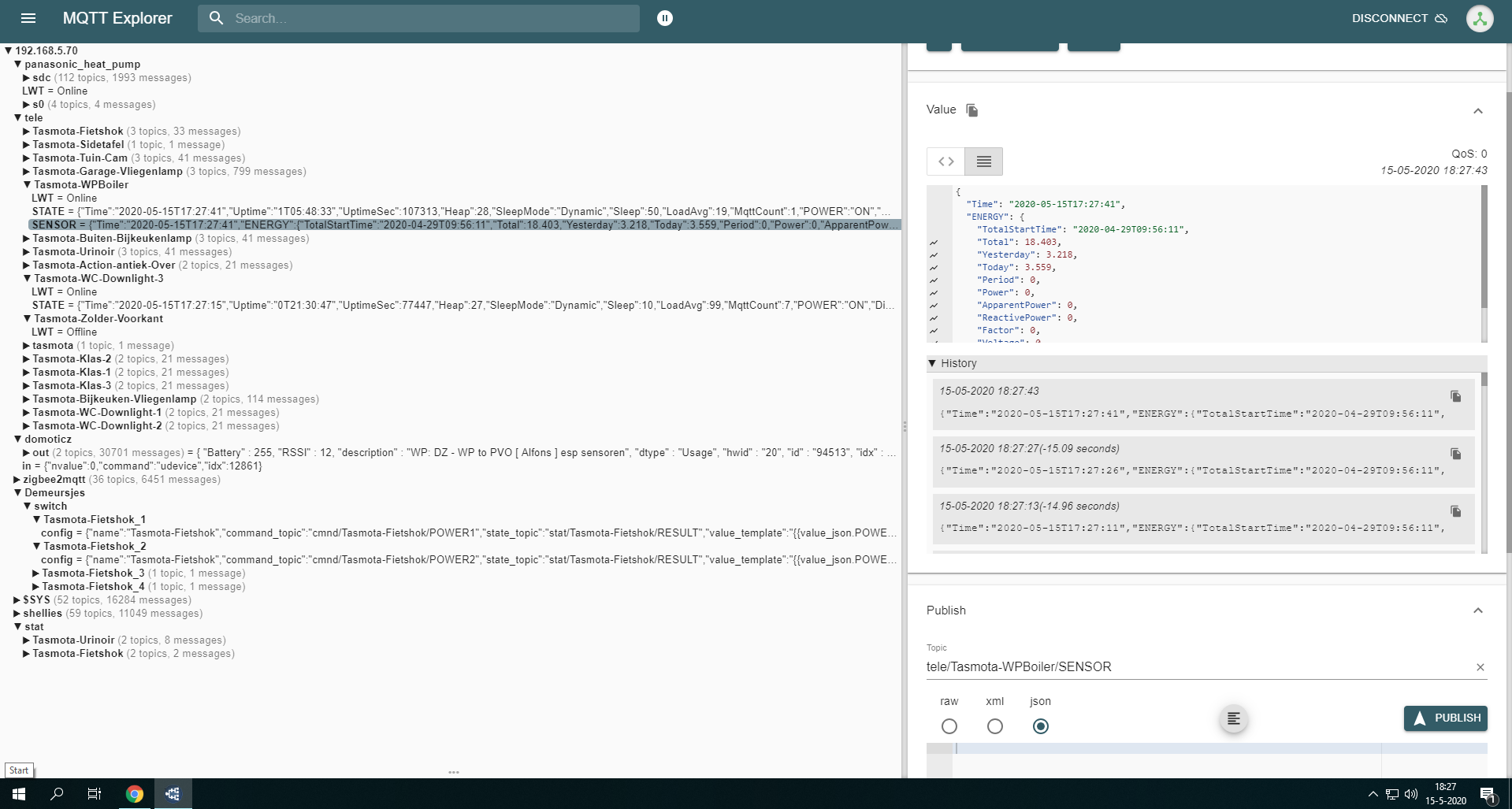

Only do know perhaps also how i can read out the tasmota usage and poer?
I see a lot of data, only not on the same structure like a shelly..
Thanks!!!

the deactivated nodes will switch the shelly from Domoticz, (you need to adjust device ID , etc.)
the second strain will report on/off status to Domoticz, which is useful, if you you switch from the shelly web interface or manually.
For Tasmota I don't know, since I don't have any devices. but I assume they have a specified API, just like Shelly.
I found this one:
https://tasmota.github.io/docs/MQTT/
edit: I looked a bit deeper into your screenshot, I think the required data should be easy to extract from that payload. you probably just need th change the coding in the function node(s) to parse the values you need.
