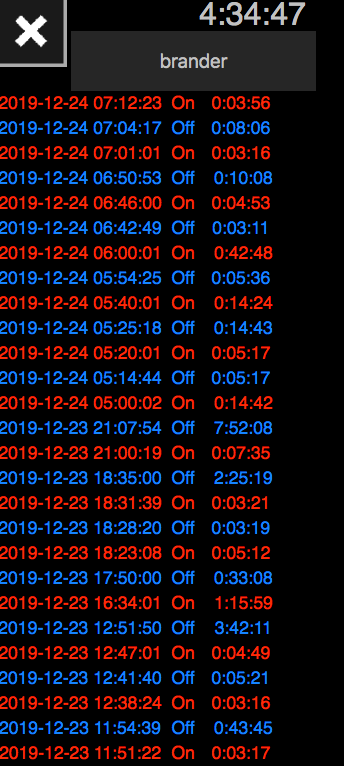

Something like this?
Screenshot at dec. 24 07-16-37.png (136.46 KiB) Viewed 642 times
This shows the on/off times of the last 24 hours.
My log history is set to 1 day to keep the SQLite database as small as possible.
I also run a script every hour to remove records from not used devices and non-interest ones.
Still in 1 day there're already 3000 records. You want to keep that for years?
That'll be a huge growing table.
What I do besides this is pushing the switch times to a MySQL database for a few devices I want to monitor.
I do this since December 1st for 7 devices , the table already holds 3734 records.
