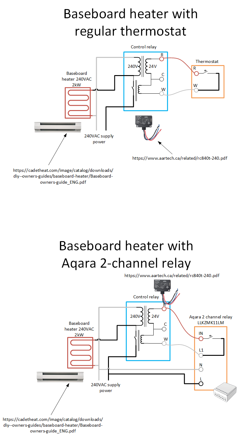

LLKZMK11LM Aqara wireless relay controller for baseboard heater
molod
Joined: Wednesday 25 December 2019 21:38
Target OS: OS X
Post by molod »
Do you think this will work with Aquara relay? I have checked few video and review and because it is said that it does not support dry contacts I afraid that it may not be suitable for this application. Thoughts?
