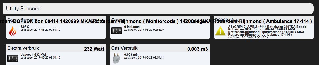

And now that we have a GRIP 2 situation in my region, it doesn't show on Domoticz :(
EdwinK
Posts: 1820
Location: Rhoon
Re: P2000 to Domoticz for central ventilation
Post by EdwinK »
Mmm... Now the alerts show up.
EdwinK
Posts: 1820
Location: Rhoon
Post by EdwinK »
Something looks wrong. I think I get the same data over and over.
2017-08-22 00:13:03 A1 (GRIP: 2) AMBU 17114 Botlekweg 3197KA Botlek Rotterdam BOTLEK bon 80414 1420999 MKA Rotterdam-Rijnmond ( Monitorcode ) 1420014 MKA Rotterdam-Rijnmond ( Ambulance 17-114 )
2017-08-22 00:12:03 A1 (GRIP: 2) AMBU 17114 Botlekweg 3197KA Botlek Rotterdam BOTLEK bon 80414 1420999 MKA Rotterdam-Rijnmond ( Monitorcode ) 1420014 MKA Rotterdam-Rijnmond ( Ambulance 17-114 )
2017-08-22 00:11:03 A1 (GRIP: 2) AMBU 17114 Botlekweg 3197KA Botlek Rotterdam BOTLEK bon 80414 1420999 MKA Rotterdam-Rijnmond ( Monitorcode ) 1420014 MKA Rotterdam-Rijnmond ( Ambulance 17-114 )
2017-08-22 00:10:07 A1 (GRIP: 2) AMBU 17114 Botlekweg 3197KA Botlek Rotterdam BOTLEK bon 80414 1420999 MKA Rotterdam-Rijnmond ( Monitorcode ) 1420014 MKA Rotterdam-Rijnmond ( Ambulance 17-114 )
2017-08-22 00:09:02 A1 (GRIP: 2) AMBU 17114 Botlekweg 3197KA Botlek Rotterdam BOTLEK bon 80414 1420999 MKA Rotterdam-Rijnmond ( Monitorcode ) 1420014 MKA Rotterdam-Rijnmond ( Ambulance 17-114 )
2017-08-22 00:08:02 A1 (GRIP: 2) AMBU 17114 Botlekweg 3197KA Botlek Rotterdam BOTLEK bon 80414 1420999 MKA Rotterdam-Rijnmond ( Monitorcode ) 1420014 MKA Rotterdam-Rijnmond ( Ambulance 17-114 )
2017-08-22 00:07:02 A1 (GRIP: 2) AMBU 17114 Botlekweg 3197KA Botlek Rotterdam BOTLEK bon 80414 1420999 MKA Rotterdam-Rijnmond ( Monitorcode ) 1420014 MKA Rotterdam-Rijnmond ( Ambulance 17-114 )
2017-08-22 00:06:03 A1 (GRIP: 2) AMBU 17114 Botlekweg 3197KA Botlek Rotterdam BOTLEK bon 80414 1420999 MKA Rotterdam-Rijnmond ( Monitorcode ) 1420014 MKA Rotterdam-Rijnmond ( Ambulance 17-114 )
2017-08-22 00:05:06 A1 (GRIP: 2) AMBU 17114 Botlekweg 3197KA Botlek Rotterdam BOTLEK bon 80414 1420999 MKA Rotterdam-Rijnmond ( Monitorcode ) 1420014 MKA Rotterdam-Rijnmond ( Ambulance 17-114 )
2017-08-22 00:04:03 A1 (GRIP: 2) AMBU 17114 Botlekweg 3197KA Botlek Rotterdam BOTLEK bon 80414 1420999 MKA Rotterdam-Rijnmond ( Monitorcode ) 1420014 MKA Rotterdam-Rijnmond ( Ambulance 17-114 )
2017-08-22 00:03:03 A1 (GRIP: 2) AMBU 17114 Botlekweg 3197KA Botlek Rotterdam BOTLEK bon 80414 1420999 MKA Rotterdam-Rijnmond ( Monitorcode ) 1420014 MKA Rotterdam-Rijnmond ( Ambulance 17-114 )
2017-08-22 00:02:02 A1 (GRIP: 2) AMBU 17114 Botlekweg 3197KA Botlek Rotterdam BOTLEK bon 80414 1420999 MKA Rotterdam-Rijnmond ( Monitorcode ) 1420014 MKA Rotterdam-Rijnmond ( Ambulance 17-114 )
2017-08-22 00:01:02 A1 (GRIP: 2) AMBU 17114 Botlekweg 3197KA Botlek Rotterdam BOTLEK bon 80414 1420999 MKA Rotterdam-Rijnmond ( Monitorcode ) 1420014 MKA Rotterdam-Rijnmond ( Ambulance 17-114 )
2017-08-22 00:00:06 A1 (GRIP: 2) AMBU 17114 Botlekweg 3197KA Botlek Rotterdam BOTLEK bon 80414 1420999 MKA Rotterdam-Rijnmond ( Monitorcode ) 1420014 MKA Rotterdam-Rijnmond ( Ambulance 17-114 )
2017-08-21 23:59:02 A1 (GRIP: 2) AMBU 17114 Botlekweg 3197KA Botlek Rotterdam BOTLEK bon 80414 1420999 MKA Rotterdam-Rijnmond ( Monitorcode ) 1420014 MKA Rotterdam-Rijnmond ( Ambulance 17-114 )
2017-08-21 23:58:02 A1 (GRIP: 2) AMBU 17114 Botlekweg 3197KA Botlek Rotterdam BOTLEK bon 80414 1420999 MKA Rotterdam-Rijnmond ( Monitorcode ) 1420014 MKA Rotterdam-Rijnmond ( Ambulance 17-114 )
2017-08-21 23:57:02 A1 (GRIP: 2) AMBU 17114 Botlekweg 3197KA Botlek Rotterdam BOTLEK bon 80414 1420999 MKA Rotterdam-Rijnmond ( Monitorcode ) 1420014 MKA Rotterdam-Rijnmond ( Ambulance 17-114 )
2017-08-21 23:56:03 A1 (GRIP: 2) AMBU 17114 Botlekweg 3197KA Botlek Rotterdam BOTLEK bon 80414 1420999 MKA Rotterdam-Rijnmond ( Monitorcode ) 1420014 MKA Rotterdam-Rijnmond ( Ambulance 17-114 )
2017-08-21 23:55:06 A1 (GRIP: 2) AMBU 17114 Botlekweg 3197KA Botlek Rotterdam BOTLEK bon 80414 1420999 MKA Rotterdam-Rijnmond ( Monitorcode ) 1420014 MKA Rotterdam-Rijnmond ( Ambulance 17-114 )
2017-08-21 23:54:03 A1 (GRIP: 2) AMBU 17114 Botlekweg 3197KA Botlek Rotterdam BOTLEK bon 80414 1420999 MKA Rotterdam-Rijnmond ( Monitorcode ) 1420014 MKA Rotterdam-Rijnmond ( Ambulance 17-114 )
2017-08-21 23:53:03 A1 (GRIP: 2) AMBU 17114 Botlekweg 3197KA Botlek Rotterdam BOTLEK bon 80414 1420999 MKA Rotterdam-Rijnmond ( Monitorcode ) 1420014 MKA Rotterdam-Rijnmond ( Ambulance 17-114 )
2017-08-21 23:52:03 A1 (GRIP: 2) AMBU 17114 Botlekweg 3197KA Botlek Rotterdam BOTLEK bon 80414 1420999 MKA Rotterdam-Rijnmond ( Monitorcode ) 1420014 MKA Rotterdam-Rijnmond ( Ambulance 17-114 )
2017-08-21 23:51:03 A1 (GRIP: 2) AMBU 17114 Botlekweg 3197KA Botlek Rotterdam BOTLEK bon 80414 1420999 MKA Rotterdam-Rijnmond ( Monitorcode ) 1420014 MKA Rotterdam-Rijnmond ( Ambulance 17-114 )
2017-08-21 23:50:05 A1 (GRIP: 2) AMBU 17114 Botlekweg 3197KA Botlek Rotterdam BOTLEK bon 80414 1420999 MKA Rotterdam-Rijnmond ( Monitorcode ) 1420014 MKA Rotterdam-Rijnmond ( Ambulance 17-114 )
2017-08-21 23:49:03 A1 (GRIP: 2) AMBU 17114 Botlekweg 3197KA Botlek Rotterdam BOTLEK bon 80414 1420999 MKA Rotterdam-Rijnmond ( Monitorcode ) 1420014 MKA Rotterdam-Rijnmond ( Ambulance 17-114 )
2017-08-21 23:48:03 A1 (GRIP: 2) AMBU 17114 Botlekweg 3197KA Botlek Rotterdam BOTLEK bon 80414 1420999 MKA Rotterdam-Rijnmond ( Monitorcode ) 1420014 MKA Rotterdam-Rijnmond ( Ambulance 17-114 )
2017-08-21 23:47:03 A1 (GRIP: 2) AMBU 17114 Botlekweg 3197KA Botlek Rotterdam BOTLEK bon 80414 1420999 MKA Rotterdam-Rijnmond ( Monitorcode ) 1420014 MKA Rotterdam-Rijnmond ( Ambulance 17-114 )
2017-08-21 23:46:03 A1 (GRIP: 2) AMBU 17114 Botlekweg 3197KA Botlek Rotterdam BOTLEK bon 80414 1420999 MKA Rotterdam-Rijnmond ( Monitorcode ) 1420014 MKA Rotterdam-Rijnmond ( Ambulance 17-114 )
2017-08-21 23:45:06 A1 (GRIP: 2) AMBU 17114 Botlekweg 3197KA Botlek Rotterdam BOTLEK bon 80414 1420999 MKA Rotterdam-Rijnmond ( Monitorcode ) 1420014 MKA Rotterdam-Rijnmond ( Ambulance 17-114 )
2017-08-21 23:44:03 A1 (GRIP: 2) AMBU 17114 Botlekweg 3197KA Botlek Rotterdam BOTLEK bon 80414 1420999 MKA Rotterdam-Rijnmond ( Monitorcode ) 1420014 MKA Rotterdam-Rijnmond ( Ambulance 17-114 )
2017-08-21 23:43:03 A1 (GRIP: 2) AMBU 17114 Botlekweg 3197KA Botlek Rotterdam BOTLEK bon 80414 1420999 MKA Rotterdam-Rijnmond ( Monitorcode ) 1420014 MKA Rotterdam-Rijnmond ( Ambulance 17-114 )
2017-08-21 23:42:03 A1 (GRIP: 2) AMBU 17114 Botlekweg 3197KA Botlek Rotterdam BOTLEK bon 80414 1420999 MKA Rotterdam-Rijnmond ( Monitorcode ) 1420014 MKA Rotterdam-Rijnmond ( Ambulance 17-114 )
2017-08-21 23:41:03 A1 (GRIP: 2) AMBU 17114 Botlekweg 3197KA Botlek Rotterdam BOTLEK bon 80414 1420999 MKA Rotterdam-Rijnmond ( Monitorcode ) 1420014 MKA Rotterdam-Rijnmond ( Ambulance 17-114 )
2017-08-21 23:40:06 A1 (GRIP: 2) AMBU 17114 Botlekweg 3197KA Botlek Rotterdam BOTLEK bon 80414 1420999 MKA Rotterdam-Rijnmond ( Monitorcode ) 1420014 MKA Rotterdam-Rijnmond ( Ambulance 17-114 )
2017-08-21 23:39:03 A1 (GRIP: 2) AMBU 17114 Botlekweg 3197KA Botlek Rotterdam BOTLEK bon 80414 1420999 MKA Rotterdam-Rijnmond ( Monitorcode ) 1420014 MKA Rotterdam-Rijnmond ( Ambulance 17-114 )
EdwinK
Posts: 1820
Location: Rhoon
Post by EdwinK »
Screen Shot 2017-08-22 at 09.58.52.png (91.04 KiB) Viewed 5236 times
