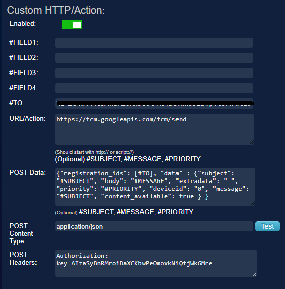

Below what I filled-in for notifications to one android device with domoticz lite.
The log file does not give any error, but no notification arrived to mobile phone

Ittiz
Posts: 48
Joined: Tuesday 03 January 2017 0:37
Domoticz version: 13939
Location: USA
Re: Getting Google Cloud Notifications to Work on Stable
Post by Ittiz »
Looks like you're missing the "8" at the end of the authorization key.
