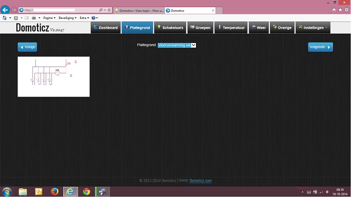

This is what i get in Windows8 with IE10
1920x1080
If I use Firefox then is the size ok
1920x1080
- Dnpwwo
- Posts: 820
- Joined: Sunday 23 March 2014 9:00
- Location: Melbourne, Australia
Re: How use Room Plan ?
Ok, when you said "its too small" you really meant "its too small"
I can't reproduce this on IE 8, IE 11, Firefox, chrome or iOS so I'm thinking its an IE 10 bug. Can you try upgrading to IE 11? That is one of the browsers I test against before releasing code.

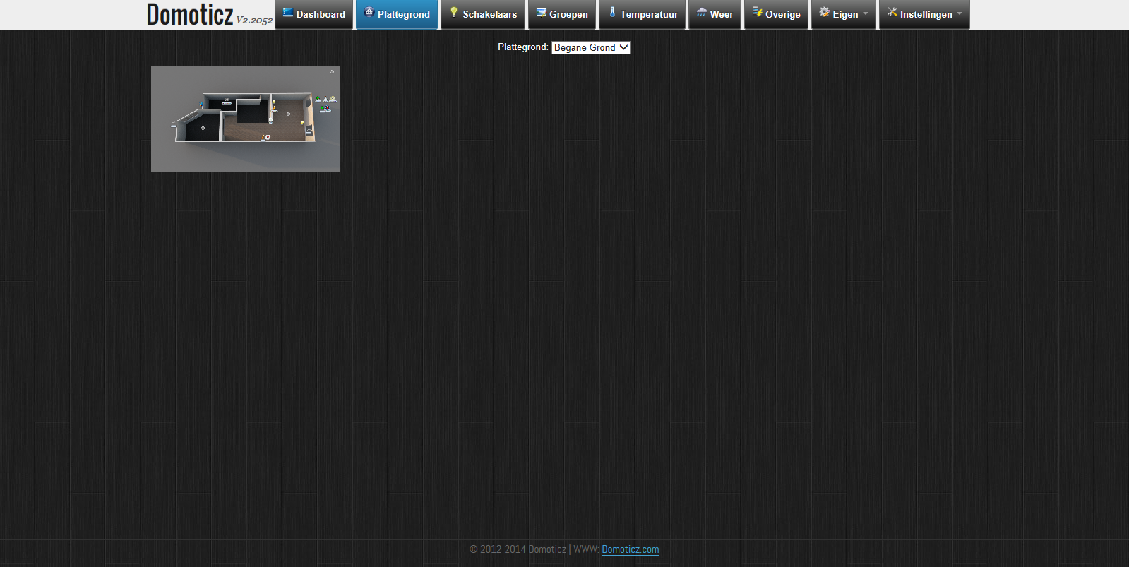

Same issue here using IE11
- Domoticz Floorplan Error.png (245.05 KiB) Viewed 16036 times

Should be sorted in build 2053.
Some code got 'optimised' in the move to angularjs so I've 'de-optimised' again
Let me know if this doesn't fix it.

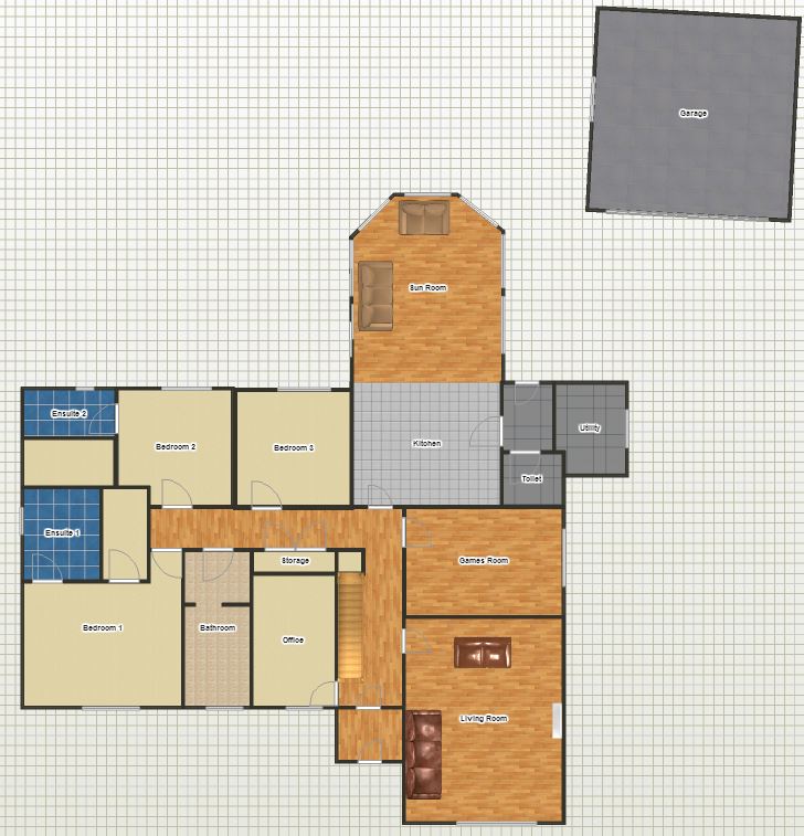

A useful link to a free 2D/3D online floor plan s/w. I did my ground floor to scale in 10 mins as I simply took a photo of my paper plans and uploaded as a background and 2 simple scale markers on the photo!
http://www.homestyler.com/designer
I could add property boundary/drive/grass/soil/decking etc

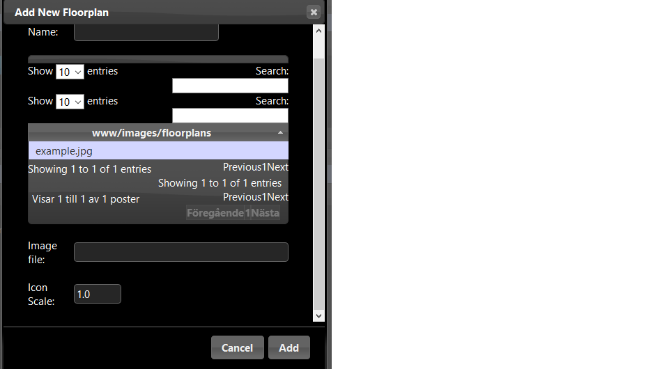

I'm stuck on step 1. Exactly how do i put my floorplanimages to the Domoticz server?
As you probably guessed, I'm not very good at linux...
Edit: Figured it out by myself, didn't know that Raspberry was ready for ftp...

RaspberryHow do I import image (jpg) to floorplanedit
