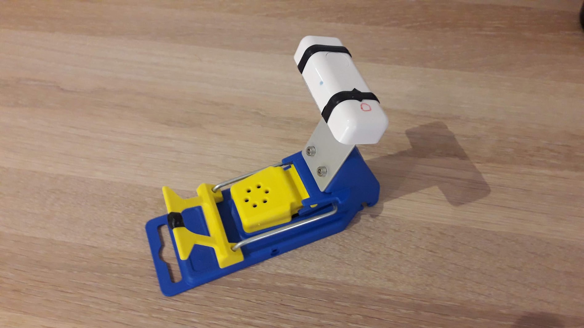

Just a small project I just finished. I'm too lazy to go down in the basement every day and check the mousetrap, so I attached a 433Mhz Telldus Magnetic door sensor to the trap and a small magnet on the hammer. Then I set up a notification in Domoticz that sends an email when the hammer falls.
Hope this can inspire someone else! :D
