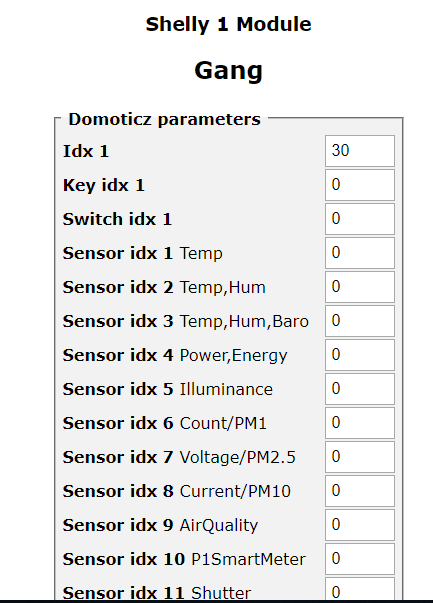

And some pictures. MQTT config in Shelly:
(I cannot get rid of the username/pass? ) Domoticz config in Shelly: And the device in Domoticz. As you can see it updates the last seen status after I pressed the toggle button in the Tasmota web interface:
