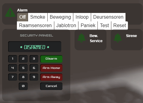

Is there a way to get the buttons (off, smoke, beweging....) right of the title?
Jablotron connection, Ikea
HansieNL
Posts: 969
Re: Dashticz v3.2.0 beta
Post by HansieNL »
pvklink wrote: Wednesday 27 November 2019 20:55 Is there a way to get the buttons (off, smoke, beweging....) right of the title?
Not sure if there’s a hard break, but otherwise you can try:
block_438 br:nth-child(2) {
   display: none
If you size your block
height: 100%
than everything will fit in the block.

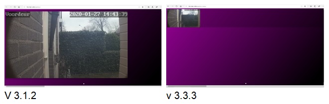

I updated from 3.1.2 to 3.3.3
Most is fixed, changed button images to btnimage etc.
But now, I can’t get my camera image showing in a larger size.
It’s a button on screen 4, if someone is at the door is slides to this screen.
Touching it, or after 10 seconds, it slides back to screen 1.
The camera image is not a real stream, it updates every second.
I changed the size in custom.css but it is probably not the best way to do this. It was just trial and error and it worked for the older version.
CONFIG.js
buttons.webcam = {width:12, isimage:true, refreshimage:2000, forcerefresh: true, image: 'http://192.168.1.150:8888/shotDoorBig.jpg?nocache=<?php echo time(); ?>',refreshurl: 2000, forcerefresh: true, slide:0}
columns[11] = {}
columns[11]['blocks'] = [buttons.webcam]
columns[11]['width'] = 12;
screens[4] = {}
screens[4]['background'] = '../dashticz/custom/img/bgZwartPaars02.jpg';
screens[4]['columns'] = [11]
F12 console of the buttons:
//v3.1.2
<div id="block_41">
	<div class="col-xs-12 hover  transbg buttons-41 slide slide0" data-id="buttons.41">
		<img id="buttonimg_41" style="max-width:100%;" src="./vendor/dashticz/nocache.php?http://user:[email protected]:443/tmpfs/auto.jpg">
	</div>
</div>
//v3.3.3
<div id="block_44" div="" <="">
	<div class="transbg col-xs-12 button dt_block hover">
		<div class="dt_content">
			<div class="dt_state">
				<img style="max-width:100%;" src="./vendor/dashticz/nocache.php?http://user:[email protected]:443/tmpfs/auto.jpg">
			</div>
		</div>
	</div>
</div>
custom.css
#buttonimg_41 {
	height:650px !important;
	max-width: 300% !Important;
Camera image big and small.jpg (27.78 KiB) Viewed 1223 times
Lokonli
Posts: 2292
Post by Lokonli »
The class definitions indeed changed a bit from 3.1.2 to 3.3.3.
The easiest way is as follows:
Add a 'key' parameter to your button definition to be able to uniquely identify your button:
buttons.webcam = {width:12, isimage:true, refreshimage:2000, forcerefresh: true, image: 'http://192.168.1.150:8888/shotDoorBig.jpg?nocache=<?php echo time(); ?>',refreshurl: 2000, forcerefresh: true, slide:0,
key:'webcam'}
Then add the following to custom.css to set a fixed width:
[data-id='webcam'] img {
   width: 600px;
Don't forget to rename image to btnimage in your CONFIG.js (Your CONFIG.js seems to be incorrect ...)
toro
Posts: 47
Joined: Wednesday 09 August 2017 23:05
Post by toro »
Lokonli, thank you very much! This works like a charm.
I tried so many things and couldn’t get it to work, but you make it seem so easy ;-)
You are right about the btnimage. I already did change it, but copied the old version here by mistake.
Thanks again for your quick reply and good solution!
