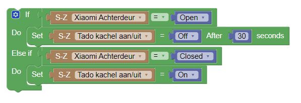

I am just getting started using blockly and i need some help.
I want to turn-off the heater when the door is open for longer than 30 seconds.
If the door is closed I would like the heater to return to the state that it was in before opening the door.
There is an option On / Off but no resume. What can I do?

Which values does the heater still have? Only on and off, or even temperature?
Mrtn83
Posts: 11
Joined: Friday 25 October 2019 22:43
Location: Vlaardingen
Re: Blockly examples
Post by Mrtn83 »
Only on or off, maybe a temperature. I would like to use the automation year round. During the summer the heater is off and shoud stay off.
But during the winter the heater should resume what it is doing.

You can try to create a Virtual Thermostat.
There you can enter the IDX for schlater and temperature.
https://www.domoticz.com/wiki/Plugins/S ... ostat.html
