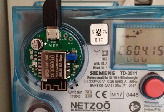

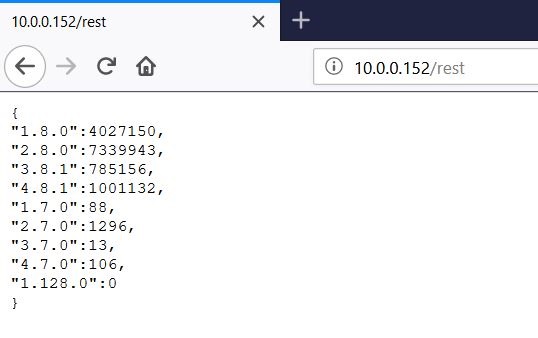

Cool! A friend of me designed a ESP8266 reader to get data via Wifi from our NETZ OÖ Siemens TD-3511 smartmeters:
Data can be read by a small LUA script or sent by MQTT.

mgerhard74 wrote: Saturday 23 November 2019 10:57 Cool! A friend of me designed a ESP8266 reader to get data via Wifi from our NETZ OÖ Siemens TD-3511 smartmeters:
Really professional looking board.
Any change you could share schematics of the reader?

Hi Jinja1l ,
this Amis-Reader project is "open source". So we share schematics, PCB (Eagle files) and sourcecode (soon) at my webpage: http://www.mitterbaur.at/amis-leser.html (sorry only in german)
lg
Gerhard
