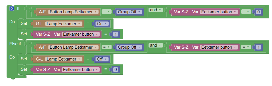

I bought an 433 button on Ali and made an event to switch on the dinnertable light, this works. But somehow this event is also triggered when I switch the kitchen light (or by event of just switch the kitchenlicht) both lights are connected to a Fibaro dimmer(seperate dimmers). And as far as I can see they are in no way connected.
I thought it might be the cheap button so I made a dummy switch to control the dinnertable light but with the same result. So the problems seems to be in the dinnertable event. (Attached as "Eetkamerlamp") I use the state "Group Off" because that's what the button triggers.

Does someone know how this could happen? I have no slave devices on my kitchenlight, and not working with groups. I only use events.

After trying and testing I figured out what the problem was. The User Variable was the one causing the problem. I made a new one and now it works fine. Why the variable was causing this stays a mistery for me. But at least this solved my problem. Maybe I can help someone with this.
