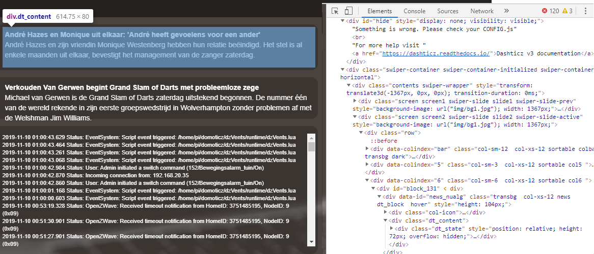

Hi, i am busy changing my styling with the new formats for special blocks...
Cam, garbage, clock & sunrise are working.
But
1.i cant style news ...
this is the js part
// NEWS FEED
blocks['news_nualg'] = {}
blocks['news_nualg']['feed'] = 'http://www.nu.nl/rss/algemeen';
and these are some samples of my css, i cant define the height of a news block like news_nualg
2. Other question: Why can i use an item like divcam1 without buttons. and for cams i have to add calenders. in front, why is this different?
* news */
div[data-id='news_nualg'] {height: 136;} /* does not work */
[data-id='news_nualg'].blocktitle {height: 136;} /* does not work */
/* cam */
div[data-id='divcam1'] {height: 172px;width: 240px;}
div[data-id='divcam2'] {height: 172px;width: 240px;}
div[data-id='divcam3'] {height: 550px;}
div[data-id='divcam4'] {height: 550px;}
/* calenders */
div[data-id='calendars.dvpeter'] {height: 133px;}
div[data-id='calendars.dvado'] {height: 133px;}
div[data-id='calendars.dvf1'] {height: 352px;}
div[data-id='calendars.dvfam'] {height: 135px;}
div[data-id='calendars.dvfam'] .items {height: 100%;overflow-y: auto;}
/* clock & sunrise */
div[data-id='clock'] {height: 118px;}
div[data-id='sunrise'] {height: 90px;}
/*  garbage */
div[data-id='garbage'] {height: 85px;width: 480px;}
div[data-id='garbage'] .items {height: 100%;overflow-y: auto;}

pvklink wrote: Sunday 10 November 2019 9:58 Hi, i am busy changing my styling with the new formats for special blocks...
But
this is the js part
// NEWS FEED
* news */
/* cam */
/* calenders */
/*  garbage */
You can set the height of a news block in CONFIG.js as follows:
    feed: 'http://www.nu.nl/rss/algemeen',
    maxheight: 400,
    title: 'Nu.nl' //optional
I see this is not documented yet...
If you have added a title to the news block, then you can change the styling of the title part in custom.css:
[data-id='news_nualg'].news .dt_title {
    height:50px
Back to your two lines that didn't work:
The first one doesn't work because normally the height is calculated dynamically by the news content, and that overrules the css styling. You can have a forced height by using the the maxheight parameter in the block definition in CONFIG.js, as described above.
The second one doesn't work, because the data-id is not added to the title, but only to the container.

This works indeed!
[data-id='news_nusp'].news .dt_title {height:25px} /* this only works if the block has a title in custom.js */
/* but this not .............still testing */
[data-id='news_nusp'].news .col-data {height: 100%;overflow-y: auto;}
blocks['news_nusp'] = {}
blocks['news_nusp']['feed'] = 'http://www.nu.nl/rss/sport';
blocks['news_nusp']['maxheight'] = 100;
blocks['news_nusp']['title'] = 'Nu.nl (sport)';

Ok, i can see the switches.
Another problem:
Script5 : toegang geweigerd.
Bestand: about:blank, regel: 1, kolom: 1
