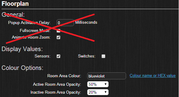

Build 2011 Added, contains application settings options and the floorplan page respects most of them, the others will be added soon.
They are under the 'Floorplan' section on the 'Application Settings' page:
The link on the right is to a page with a load of named colours.

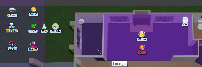

Here's what the shown settings look like (not suggesting that anyone goes with my test colour scheme :) ):
The 'Active Room' is the one the mouse is over (not so relevant for tablets) or the one you have zoomed in on.
There are a couple of minor kinks to work out but it should mostly work, let me know if there any problems and remember to refresh your browser cache to make sure you pick up the latest versions of everything.

In between, i have a question to "Dnpwwo" : I see on your picture than you are using a "Lux Sensor". As i have the project to automatise my blinds linked with luminosity, could you please indicate me what model of lux sensor you use.

@Christian, My Lux device is a part of my HSM100 clone devices (made by EzyMotion). Its a 3-in-1 PIR/Temp/Lux detector. Sadly over the last year two out of three no longer function 100% for different reasons so I'm not sure I would recommend them :(
