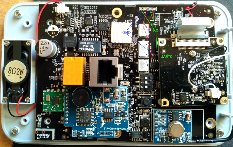

1. Conect the device with USB UART ( conect only the RX/TX and GND pins)
2. Run putty , select serial . name you com number, select baud rate at 115200 and conect
if you connected in correct order RX,TX and GND you should see a console with running lines
3.Now write in console telnetd to enable telnet

i find RX and TX on motherboard so i active telnet
thanks for script

On the device board there are 3 connectors with 3 pins, on which there is possibly uart. Which connector did you connect to?

fennec62 wrote: Friday 21 June 2019 3:53 i have this doorbell
https://fr.aliexpress.com/item/Smart-72 ... 6c37UmFt4B
Me probably too. Mainboard is identified as KW02-V200-V1.5-MAIN 2017-10-17.
Could you share a picture RX/TS you identified please?
Thank you.

Finally I identified serial myself as on the picture below. Board has three TTL serials: J3 (UART0), J47 (guess) and J60 (guess) with voltage level 3.4V which is fine for my USB CP210X dongle. Kernel console is available on UART0 (115200 8N1, no flow control) and provides standard HiLinux syslog and shell prompt. Doorbell uses ARM926EJ-S processor.
clear_boot.log
(46.85 KiB) Downloaded 216 times
System provides BusyBox telnetd which can be started from command line and then easily connected using doorbell's IP for root account with no password. System mounts read-only SQUASHFS / and temporary /etc overlay.
mount.log
(499 Bytes) Downloaded 125 times
