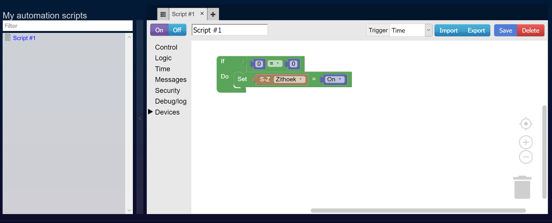

I configured my blockly script and I think it should switch my switch ('zithoek') to 'on'. However, nothing is hapening. Am I doing something wrong?

Re: Blockly not working
There is no action that trigger the If ... Do.
If <action>
Do <re-action>
This was a simple test for me for later.
Using the doorbell is: action
Light on is: reaction

Also, if I make something like this, it does not work.
Ok. I think I see the problem. The sensor is not yust giving a value, but rather a string like this 20.5;70;3;1019.7;7
I think I will have to do this with Lua...
