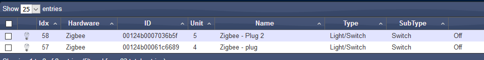

I paired the Smartplug without powermetering (902010/28) and this works flawlessly. On/Off in Domoticz puts the switch On/Off an on the switch itself Domoticz is updated.

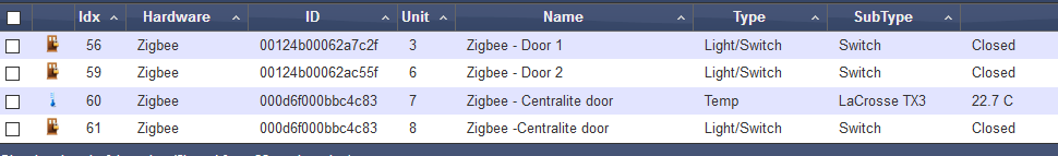

I also paired an Door/Windows contact (902010/121A). Pairing results in an Device in the Devices tab. But the device is not updated when the door is opened/closed.
In the logging i see:
2019-08-14 15:28:15.434 (Zigbee) Decode8401 MsgZoneStatus: 14
2019-08-14 15:28:16.395 (Zigbee) Decode8401 MsgZoneStatus: 14
2019-08-14 15:37:48.300 (Zigbee) Decode8401 MsgZoneStatus: 15
2019-08-14 15:37:49.318 (Zigbee) Decode8401 MsgZoneStatus: 15
14 when i close the door and 15 when it is opened.

Short ID: 66c7 and b624 are Bitronvideo (902010/121A) door/windows contacts.
Short ID: 470b and 275e are Bitronvideo (902010/28) smartplugs.
Short ID: 8701 is an Centralite Micro Door/Windows contact with temperature metering.
The Plugs works fine. No further integration needed.
The Door contact, please do further integration.
New: Centralite Door/Windows contact. The temperature sensor pairs fine, but the door/windows contact has the same issue as the Bitron one. The open/close state is not updated.
See attached screenshots of the device list in Domoticz.

Hi pipiche,
Succes!!
The Bitron door sensor updates the status:
2019-08-21 06:18:08.901 (Zigbee) UpdateDevice - ( Zigbee - 3) 1:Open
2019-08-21 06:18:18.263 (Zigbee) UpdateDevice - ( Zigbee - 2) 1:Open
2019-08-21 06:18:30.001 (Zigbee) UpdateDevice - ( Zigbee - 3) 0:Closed
2019-08-21 06:18:30.341 (Zigbee) UpdateDevice - ( Zigbee - 2) 0:Closed
The Centralite device i did not test yet. Hopefully later today.

Hi Pipiche,
The widget for the Smartplug is working fine! Thanks.
