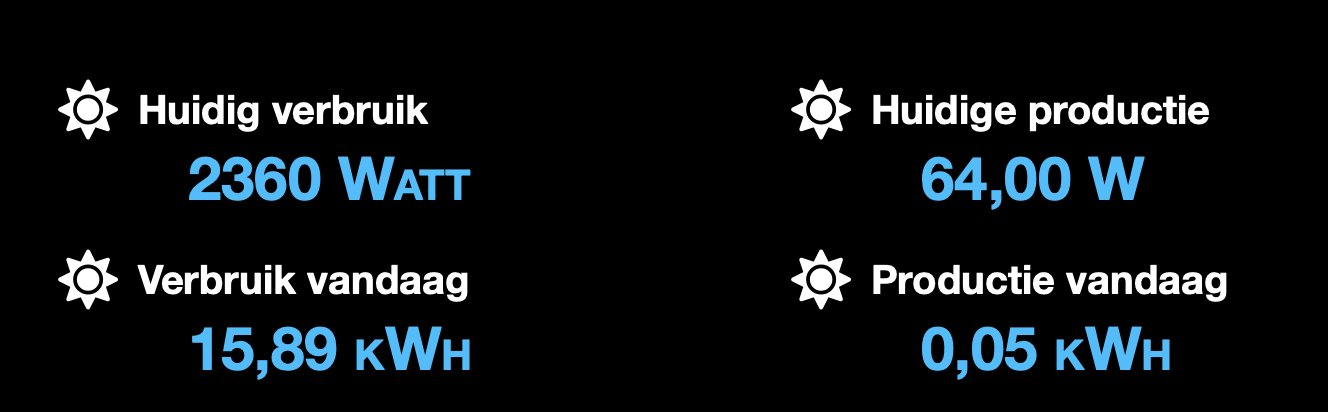

See image
I have fa-bolt icon to "huidig verbruikk" and "verbruik vandaag", but is shows the sun icon :(
In fact whatever I fill in as Icon, it does not use it and stays a sun
The config.js part is this
blocks['518_1'] = {}
blocks['518_1']['title'] = 'Huidig verbruik';
blocks['518_1']['icon'] = 'fas fa-bolt';
blocks['518_1']['width'] = 4;
blocks['518_1']['switch'] = true;
blocks['518_2'] = {}
blocks['518_2']['title'] = 'Verbruik vandaag';
blocks['518_2']['icon'] = 'fas fa-bolt';
blocks['518_2']['width'] = 4;
blocks['518_2']['switch'] = true;
Schermafbeelding 2019-09-15 om 12.05.58.png (57.83 KiB) Viewed 540 times

I've tested setting the icons for three type of devices:
* P1 power meter
* Climate device (temperature, humidity, pressure)
* Energy device (actual, total today)
on the beta branch and the master branch.
This all works.
What is the device type of the device for which you try to modify the icons?
Did you change something in custom.js? If yes, can you post that here as well?
What is the exact Dashticz version you are using?
There might be something wrong in your CONFIG.js. Can you post it here? Then I'll have a look.

You put me on the right track :-)
There was some old code in the custom.js what caused this
Thanks...
