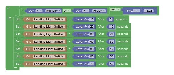

Perfect, many thanks for your help, my only issue now is either my lamp brightness does change below about 40% or my dimmer won't go lower than that, I have another bulb to try first, here is what I have anyway - the time was just to test, I don't get up that late :lol:

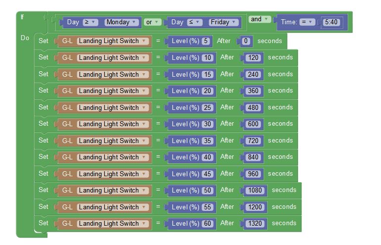

OK so I completed my weekday wakeup routine as you can see below to start at 5:40AM so it will reach 60% by about 6AM, I'm presently not too popular cause the damn thing decided it would start at 5AM this morning, anyone have any ideas why?
Weekday Wakeup .jpg (77.06 KiB) Viewed 1436 times

I followed your advice and created a dumy switch set for weekdays with a start time of 5:40AM and an off delay of 20 seconds so once the start action has been completed and detected in blockly the switch will revert to off ready for the following weekday, I also added a daylight sensor at the start so once the day light hours start to get longer again next year it will auto disable.
Tomorrow is the big test, hopefully it starts on time and doesn't wake me up nearly an hour early!

Good news, started perfectly on time and I'm now back in my fiancee's good books :D
