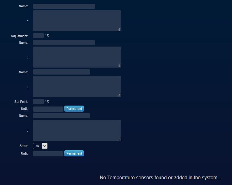

I have upgraded to the latest Domoticz beta first: 4.11316
It was pretty quick. But after it Domoticz says my sensors can't found. They are in the devices list bit for example checking the Temperature this is showed:
Where are my sensors now? Is this normal when Domoticz updated?

I can also reach the log of the sensors from device list but they don't appear under Temperature or Switches.
I have updated the plugin also to check the web interface. Page isn't visible on DomoticzIP:9440. I have added "enableWebServer": 1, on json file and Domoticz was restarded.
Can you help me please?

I don't know what happened. It works now after another Domoticz restart. :)
Sensors are visible and I can reach Web Interface. I'm in IT business but there are always things what cannot explained. :)
