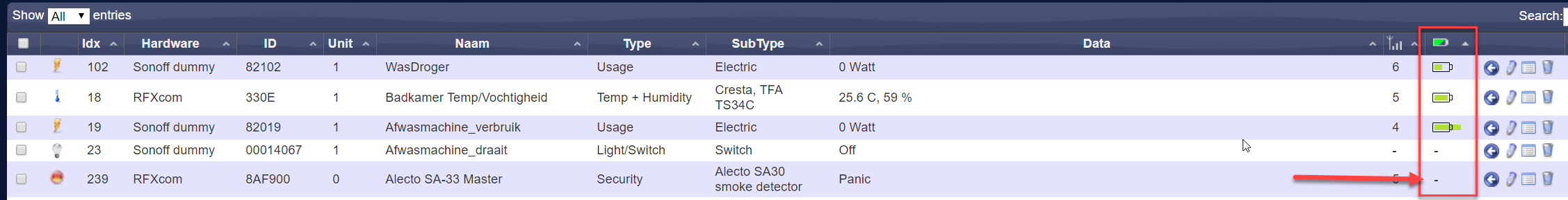

I thought I read that the batterylevel is shown in Domoticz but after connecting the smoke detectors (SA-33) the battery level is not set (see attachments. Is this possible and if so how to achieve this?

This smoke detector does not transmit a battery level nor a heart-beat.
