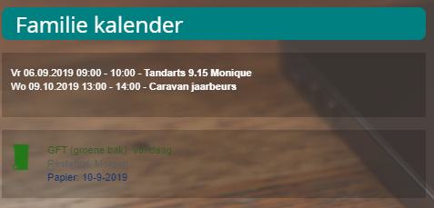

Is it possible to change the block transparancy for only the garbage background block ?
see attachment, the text and the icon is hardly readible

pvklink wrote: Thursday 22 August 2019 12:43 Is it possible to change the block transparancy for only the garbage background block ?
If you put this code in your custom.css you can change the background to the color/transparancy you like:
[data-id='garbage'] {
    background-color: rgba(0,0,0,0.5) !important;
You can change the red value from 0.1 till 1.0 to see what's best for you.

pvklink wrote: Thursday 22 August 2019 15:29 is it also possible to turn off the background block ?
so that the garbage displays as a sort of icom on the desk
Another one to try...
    opacity: 1.0 !important;
Blah blah blah

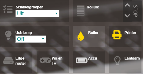

zie niet veranderen...
Heb overigens nog zo'n raar gevalletje dat de kleur vervaagd.
zie bijgevoegd image. Ik heb de blinds png zelf gemaakt en gekoppeld aan open en dicht. dat werkt goed.
vwb de kleuren heb ik de zelfde kleuren met een kleurenpicker gepkt van de iconen eronder..
en toch is het vele malen vager.....
is daar een verklaring voor en een oplossing?

pvklink wrote: Thursday 22 August 2019 16:36 wat doet dat?
Do you have the effect in both statuses of the rolluik item?
For the garbage block I think this is the one we need to completely remove the background...
    background: none !important
Hope this makes your text more readable.

no, when it is open it is sharp....closed is foggy
so it lookes that dashticz uses some kind of fog filter when the switch is off...
would be nice when you could put this on or off.
i want the bright color when my blind is closed....

pvklink wrote: Thursday 22 August 2019 17:52 no, when it is open it is sharp....closed is foggy
Dashticz applies the following styling:
.off.icon {
	opacity:0.4 !important;
So indeed all off icons have limited opacity.
You can overrule this for all off icons by adding the following to your custom.css:
.off.icon {
	opacity:1 !important;
or, if you only want to change it for a block with device id 123:
.block_123 .off.icon {

it works for on / off devices
but not for open /close
see accu, there it works (is on off)
and blinds (rolluik) is open/close
Jablotron connection, Ikea
