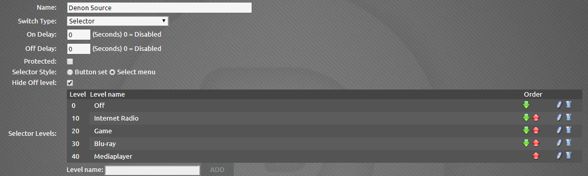

Then i wanted to expand the capabilities by creating a selector switch to change the source of the receiver.
In the actions pane i added the various urls to control the receiver. This does not work. The receiver does not respond to my requests.
Could it be that the selector switch does something to the urls which makes them unreadable for the receiver?
Here is an example of a url that works in the web browser but not from the selector switch:
http://192.168.1.244/MainZone/index.put ... eStatus%2F
Then i tried to fix this in blockly:
This also does not work, i think because the "Quoted" string is not recognized... when i tell blockly to look for != "Game" then the script fires and acts accordingly.
Any help would be greatly appreciated!

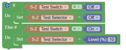

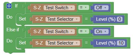

OK, so here's some testing:-
Neither Set instructions work:
Both Set instructions work
So I was incorrect (again :cry: ). When I analyzed my existing Blockleys that utilise "Off", I found them not working correctly. (I was sure they used to work), I stand corrected.
