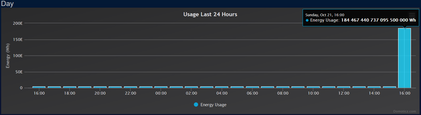

Here is an example of typical erroneous value that I would like to be able to set to zero as it's occurs after a power outtake... I guess that most would agree that the value is far from valid for a standard household and no I don't have a flux capacitor in my car. :D
What also could be nice would be the possibility to add specific rules to meters within what variables one would expect the reported values to be within when it comes to the aggregation of the values which Domoticz performs. And as mentioned, it's not a new issue, and it one of those annoying things which would be nice to find a good solution for.

your error value seem to be related some limit of a variable or that it became negative/roll around.
ULLONG_MAX Maximum value for a variable of type unsigned long long 18446744073709551615 (0xffffffffffffffff)
It is solvable by feeding a counter dummy sensor - script that correct values and fixes base value if incoming value less than counter(local variable)- to a new counter - script to update watt current/inc meter.
but it's using 2 extra dummy devices and a local variable per measuring device. if applied to say measure 20 different devices.. ugh..
i think there is code regarding s0 usb sensor hardware that already does the correction of data if it rolls back to 0 and also it feeds a current/inc meter direct accurately. shouldn't be to hard reusing that code for dummy sensors and so
