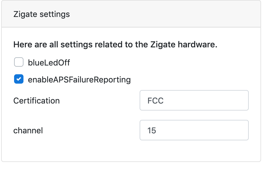

If you have only Xiaomi devices, you might set the Certification to FCC (as this is what Xiaomi rely on). This could help in the communication. ( you can do it from the Web Interface - in the Settings tab)
I would recommend you to retry the pairing of the Door contact
Last, I don't know how is the mesh level of the zigbee network, but if devices are disapearing, it could be related to communication issue.

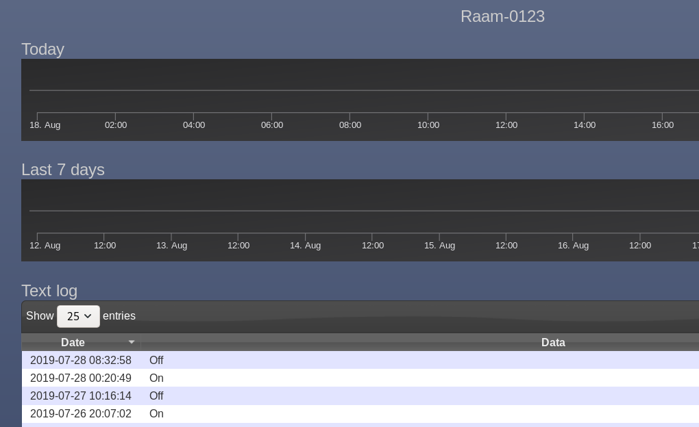

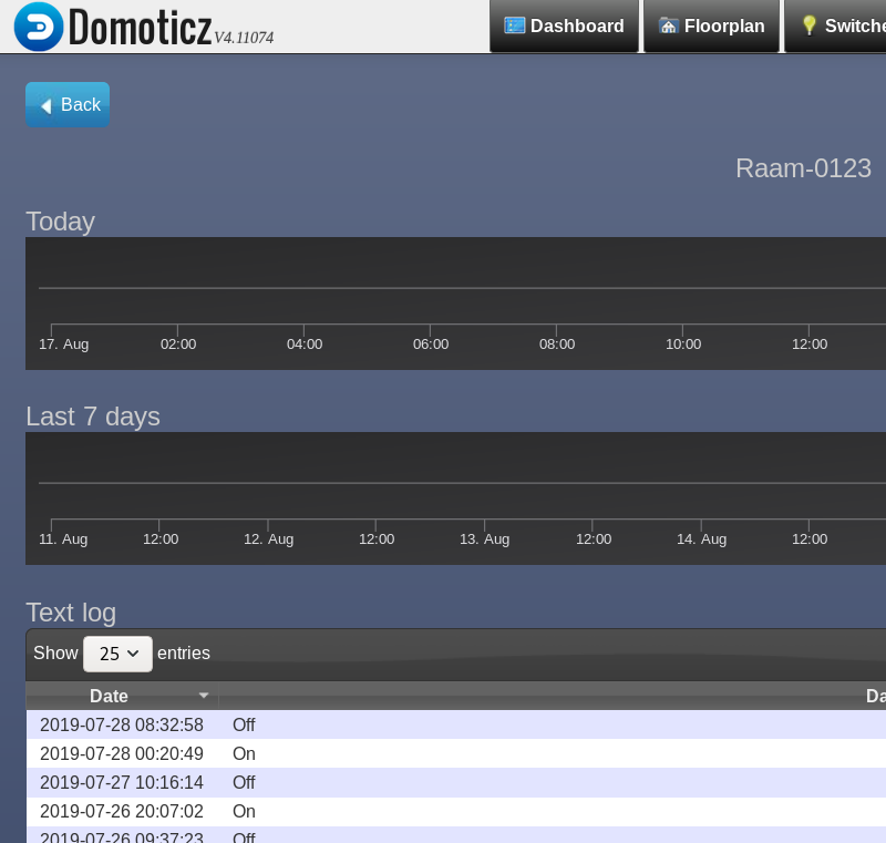

I tried it with another Door contact which is not responding anymore.
If I look at the device log I see :
2019-07-28 08:32:58 Off
2019-07-28 00:20:49 On
2019-07-27 10:16:14 Off
2019-07-26 20:07:02 On

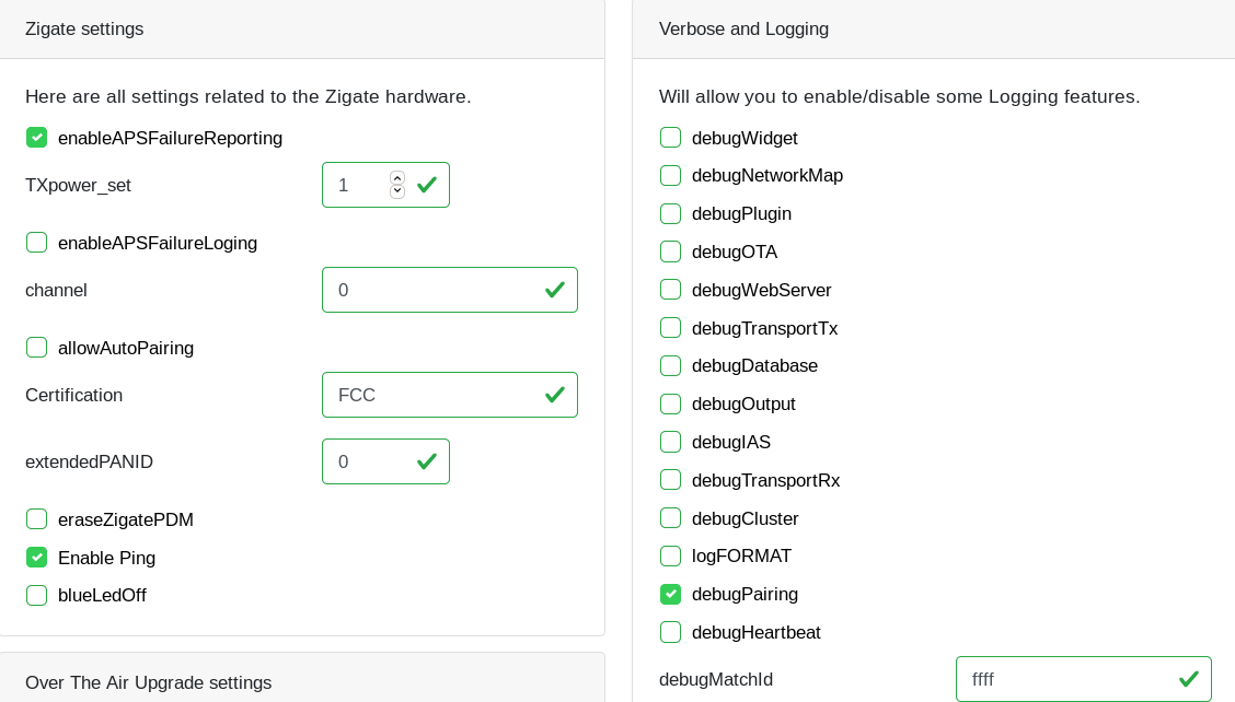

I opened the window and it is not sending info to the Zigate controler.
If I look at the admin page I see :

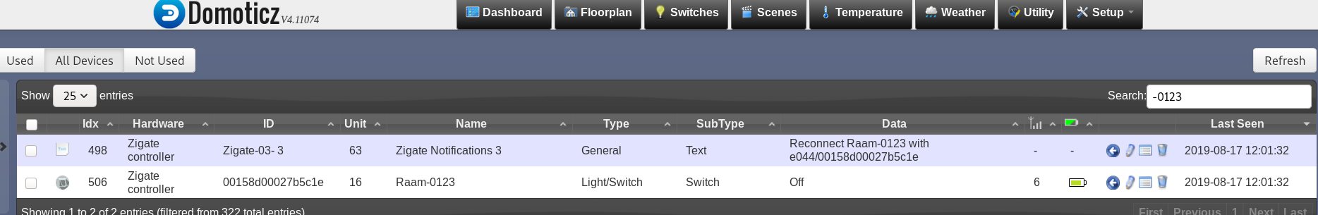

If a do a reconnect Domoticz shows me it was done :
If I touch the Door contact with the magnet I see a blue led blinking once and no action is registered towards the controller.
What else can I do ?

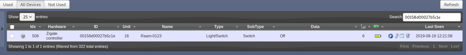

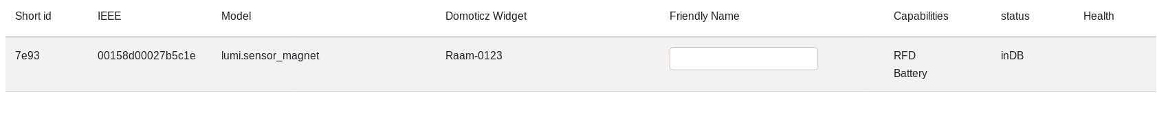

Re: Domoticz, Zigate , Not able to get all needed attributes on time
Did you set the Certification to FCC ?
What do you have in the logs ?
- Screenshot 2019-08-17 at 15.32.51.png (53.28 KiB) Viewed 2344 times
pokeron
- Posts: 8
- Joined: Friday 16 August 2019 22:34
I tried it
The result is the same, it gives these messages in the log :
2019-08-18 12:20:02.823 Status: (Zigate controller) Started.
2019-08-18 12:20:03.576 Status: (Zigate controller) Entering work loop.
2019-08-18 12:20:03.577 Status: (Zigate controller) Initialized version beta-4.6, author 'zaraki673 pipiche38'
2019-08-18 12:20:03.600 Status: (Zigate controller) Zigate plugin beta-4.6.005 started
2019-08-18 12:20:03.600 (Zigate controller) Debug: 2

2019-08-18 12:20:03.623 Status: (Zigate controller) CertificationCode set to 2
2019-08-18 12:20:03.623 Status: (Zigate controller) Certification set to FCC
2019-08-18 12:20:03.623 Status: (Zigate controller) TXpower_set set to 1

2019-08-18 12:20:13.705 Status: (Zigate controller) Zigate set to Certification : FCC

so everything seems to be ok ,
but when I close and open the contact, nothing is sent to Zigate controller, the contact blinks once.
When I want to go back from FCC to EC and push the validate button it switches back to FCC and i'm not able to go back to EC mode by using the settings page.
I have also a lot of IKEA stuff but the change from EC to FCC did not affect the working of the TRADFRI devices.
I'm not sure how to get more debug info , the setting in the plugin is : Plugin Verbose
Best Regards,
Ron

Don’t put the plugin in debug, this doesn’t really help.
Certification is ether FCC or CE ( not EC).
For your Xiaomi I suggest that you leave the plugin in FCC and then do the pairing process on the device side. Without removing anything. And put the Zigate in pairing mode ( flashing blue led)
Just saw on your screenshot that TXpower is set to 1; any reason behind that ? As 1 is putting a lot of attenuation on the Zigate transmission power !!
So make sure that it stay to 0
could you also update the plugin withcommand
git pull -
