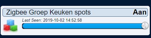

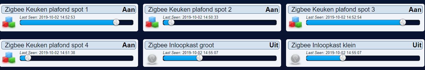

Hallo,
small issue here with Philips Hue also.
Seems like the Groups are not updating the devices..
Log after changing Group with Philips HUE bulbs:
2019-10-02 10:57:46.379 (ZigBee devices) UpdateGroup - (Zigbee Groep Woonkamer spots) 0:7
2019-10-02 10:57:46.358 Status: User: Admin initiated a switch command (15/Zigbee Groep Woonkamer spots/Set Level)
The Inloopkast has 2 Ikea Led Drivers, when i change this Group:
2019-10-02 10:59:26.984 (ZigBee devices) UpdateGroup - (Zigbee Groep Inloopkast) 1:100
2019-10-02 10:59:26.948 Status: User: Admin initiated a switch command (21/Zigbee Groep Inloopkast/On)
2019-10-02 10:59:27.141 (ZigBee devices) UpdateDevice - (Zigbee Inloopkast klein) 1:On
2019-10-02 10:59:27.198 (ZigBee devices) UpdateDevice - (Zigbee Inloopkast groot) 1:On
So no updating problem for the Ikea devices, only Philips HUE.
The version of the Domoticz plugin: 4.5.4
Zigate Firmware: V3.1
pipiche
Posts: 2027
Re: Zigate - Devices not updating status
Post by pipiche »
I do not have any Hue to test, but by understanding is that they do not report there status when a command is send to them.
In order to workaround that , you have to enable Polling via the Web Admin interface
Post by OedzesG »
Are there some special settings needed for Hue?
Also now with polling its verry strange..
When ik switch the Group.. Zigate is updating the group instead of the devices.
For example.. when ik set manualy the slider of the dimmer to 90% in flashes back to 60%
And the seperated devices in Domoticz witch belongs to that group are not updated...
2019-10-02 14:52:26.853 (ZigBee devices) UpdateGroup - (Zigbee Groep Keuken spots) 1:52

pipiche
Posts: 2027
Post by pipiche »
When using the Group command, the device will be updated via the polling, so until we have the polling done on the device, it will remain on the previous state.
Then after the group command, the group can be updated by the plugin at the next cycle with the devices state which belongs to this group.
This is problably what you experienced.
As the Hue Automatic Reporting doesn't work, this explain and we do not have much option than expecting an update of the devices accoridngly to the polling frequency
