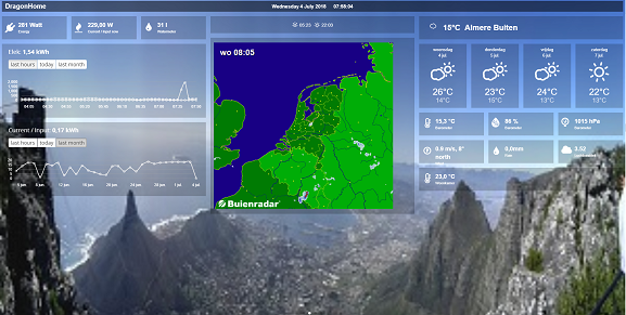

Does graph function support IDX with three digits ?
I have in Domoticz twice my solar panels..
IDX 66 generated by omnik script and recently IDX 945 , generated by Domoticz by import PVOutput.
Graph_66 works but does not show solar curve (Power generated( see screenshot)
I think I got cause of no solar curve : I use 3 PVOutput and imported power usage into Solar ID
When I change (in CONFIG.js) 'graph_66' to 'graph_945' it does not show graphics.
I tested with some more utility sensors of domoticz, it looks like graph function does not works when idx is set above 99.
Ccan some one confirm or point me in right direction?
