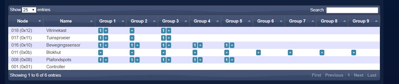

i had a power outage yesterday and as a result a qubino device(device 11) is not passing temp info anymore.
it is visible, it switches the light on/off but it does not give out temp anymore
i looked at the groups and noticed the group info for this specific device is gone.
the controller(1) needs to be in group 9 for the temp
problem however is i can not add 1 to the group or any other group of this device
is there a way to edit this manually?
