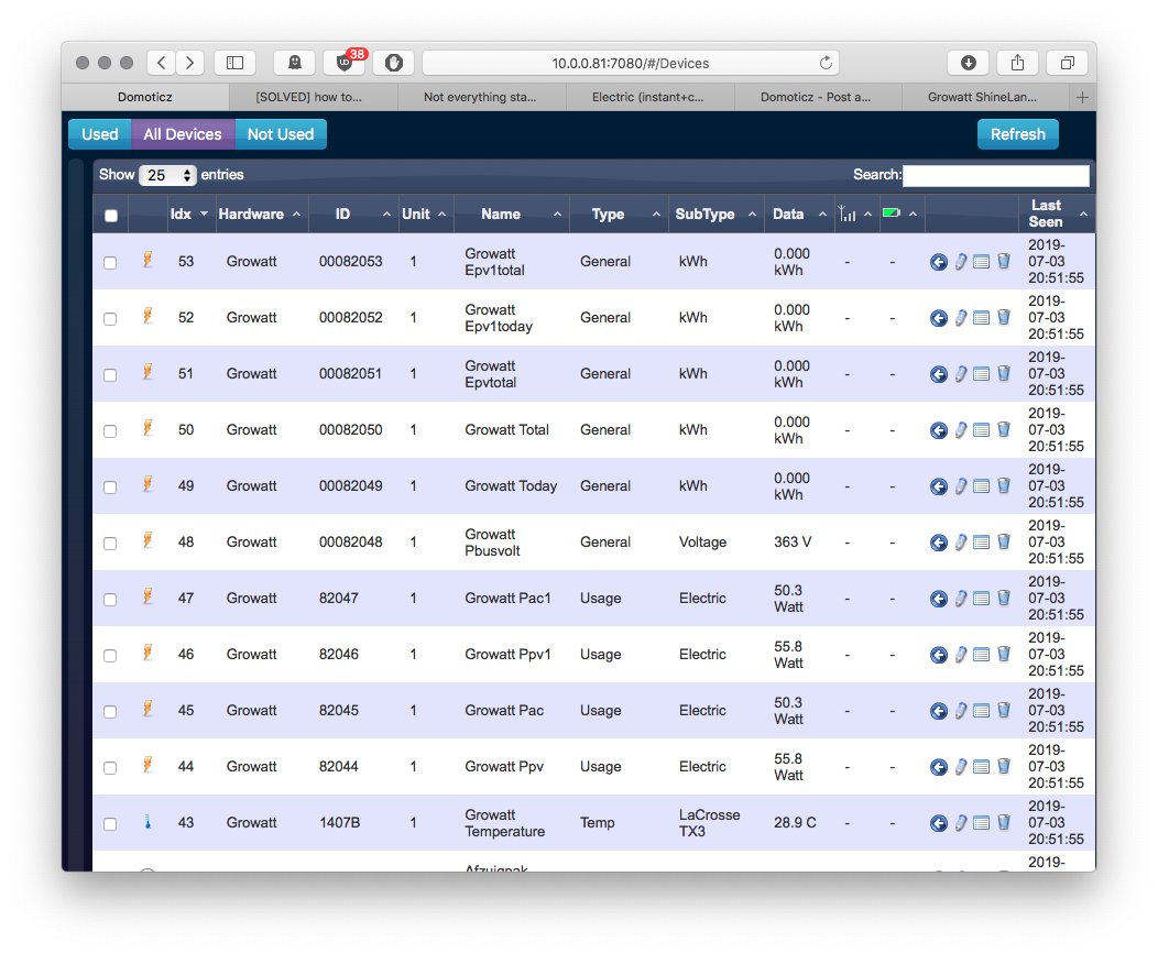

Growatt Inverter
Only for v2 of the protocol (v5 not supported, check out https://gitlab.com/jeroenrnl/nrg)
alpha growatt domoticz server https://github.com/Tristan79/Growatt-WiFi-Tools
It still needs some fine tunning :-) And I hardcoded the idx :-) And I don't know if the kwh counters are correctly communicated... but sun almost gone, tomorrow! but at least I got data in domoticz :-)
Signed TRiXWooD
Screenshot 2019-07-03 at 21.06.30.png (342.84 KiB) Viewed 2811 times
