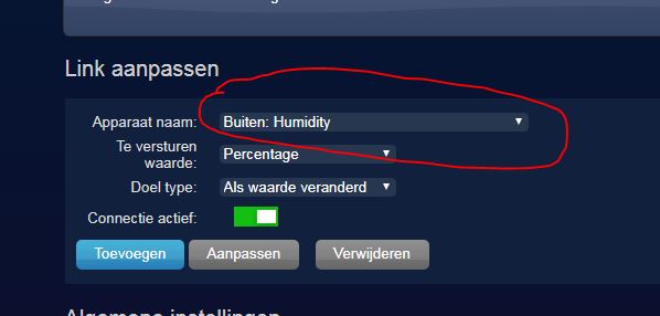

  • How do I make my custom sensor values go into influxdb if my cusyom device is not shown in the list of devices available for logging into influxdb?
    influxdb device selection.JPG (27.97 KiB) Viewed 874 times
