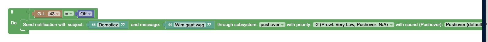

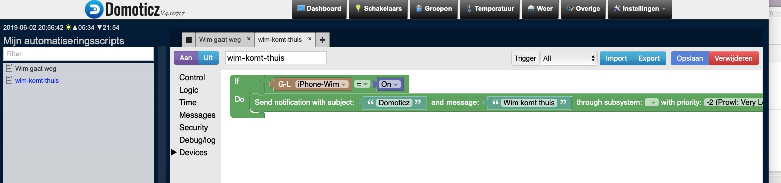

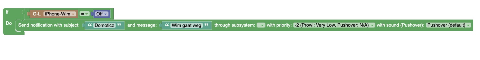

These are the screenshots of the 2 Blocky's that I have created.
- Schermafbeelding 2019-06-02 om 20.59.54.jpg (105.55 KiB) Viewed 3097 times
- Schermafbeelding 2019-06-06 om 18.26.15.jpg (49.75 KiB) Viewed 3097 times
- waaren
- Posts: 6028
Re: problems saving a blocky script

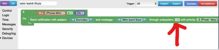

You seem to have missed to fill the subsystem blocks. If you press the down arrow in that block you will see the available subsystems. You need to configure these subsystems in the [setting] [notification] tabrunskater wrote: Friday 07 June 2019 21:38 These are the screenshots of the 2 Blocky's that I have created.
And while your at it. Change the trigger to device and active to on before saving

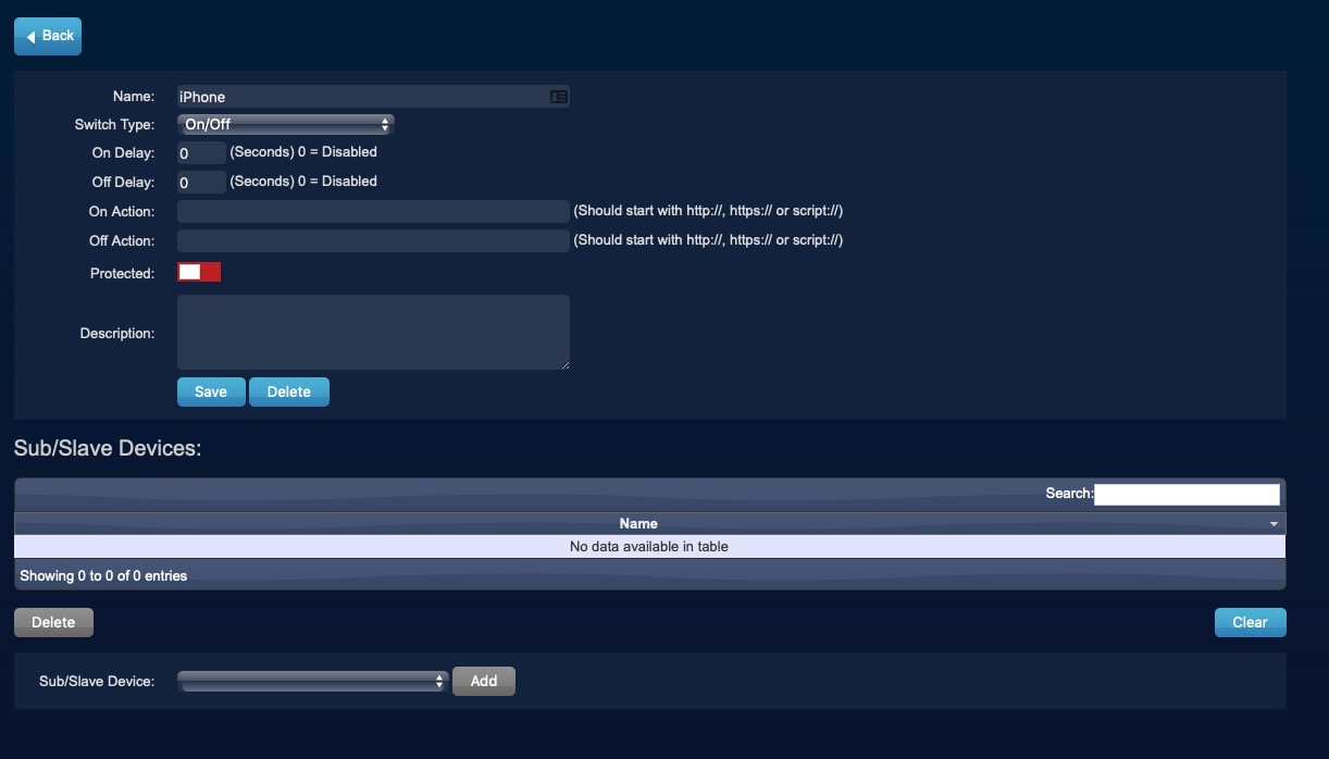

I made the changes you suggested but unfortunately it still is not working for me. It might be that I misunderstand what you are saying regarding your saying: "And while your at it. Change the trigger to device and active to on before saving" I could not find that.
Let me explain what I have done:
-- created a dummy hardware, named it 'dummy'
- went into Switches and clicked on 'Manual light/switch"
selecterd hardware: selected the above created dummy hardware, named it: iPhone
Sselected witch type: On/Off
selected type: X10
House code: D
Unit code: 10
As: main device
See the attachment
Then I created the 2 events and selected the subsystem Pushover. This Pushover was created in Setings - Notifications. I am using the right User and Api key. I used the Test button to test the Pushover and the test was with positive result.
See the attachment
When I pushed the Switch then no Notifications is sent.
Message in the log : Status: User: Admin initiated a switch command (99/iPhone/On)
It looks look the Blocky's that I created is still not activated.

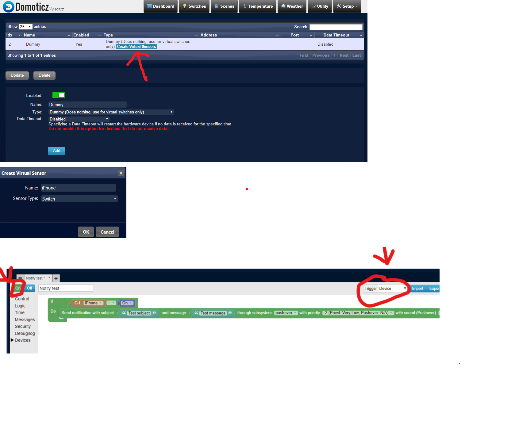

Look at the image below how to create dummy device and save active Blockly as device type. If you still don't receive the message then please double check if you applied your settings on the setup tab and set the priority of your message in the Blockly to a higher level.- went into Switches and clicked on 'Manual light/switch"
2019-06-09 23:57:08.663 Status: User: Admin initiated a switch command (1/iPhone/Off)
2019-06-09 23:57:10.904 (Dummy) Light/Switch (iPhone)
2019-06-09 23:57:10.907 EventSystem: Event triggered: Notify test_1
2019-06-09 23:57:10.770 Status: User: Admin initiated a switch command (1/iPhone/On)
2019-06-09 23:57:10.928 Status: Notification: Test subject
2019-06-09 23:57:11.932 Notification sent (pushover) => Success
