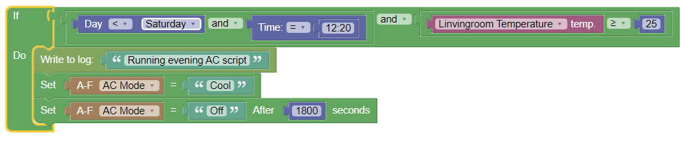

I made a block;y script that triggers on time. It checks the time and temp and if applicable sets a aircondition switch from "Off" to "Cool".
If you do this manually on the dashboard, the device changed event triggers another script acutally sending the appropiate command to the AC unit.
For some reason using the set command in the blocky script isn't working. I was quite sure this was working before upgrade to 4.10717
for testing purpose I was changing the time and temp to make sure the thing triggers. I did see the log entry "Running evening AC script" but the script listening to the device change on AC Mode never fired.
I did gave the hardware and the virtual device the same 'AC Mode' name.
Any ideas?

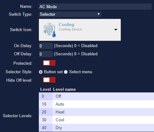

I don't work very often with Blockly and have not tested with versions before V4.10717 but to get it working with this version you will have to use a Level(%) Block because using the level-name does not set the level.
AC Mode.png (23.72 KiB) Viewed 1948 times
