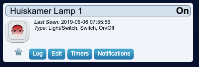

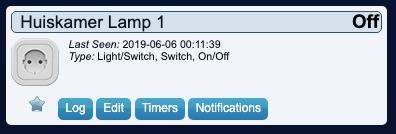

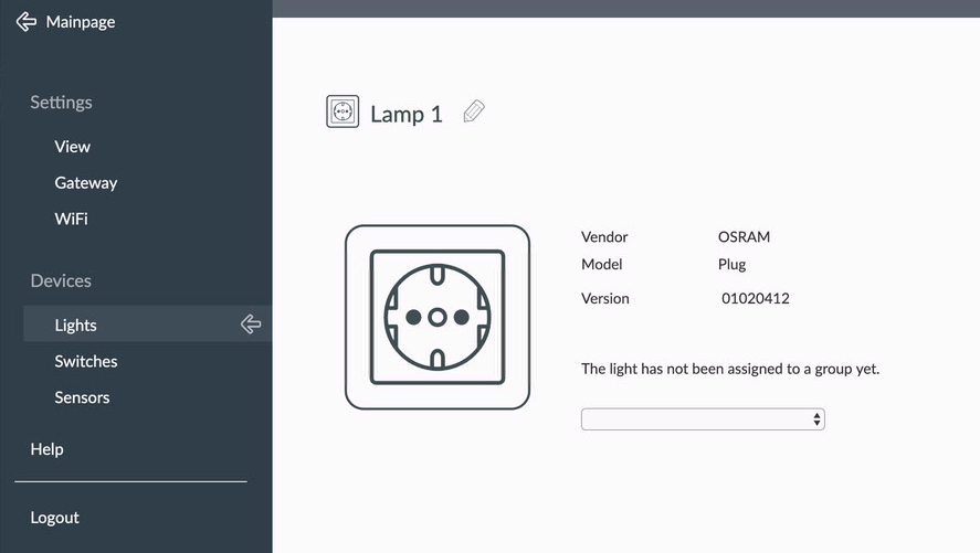

Well actually the switches are detected as lights... (see screenshot)
The product name is a Smart Plug. (https://www.google.com/aclk?sa=l&ai=DCh ... CDk&adurl=)
Screenshot 2019-06-06 at 07.31.11.png (113.12 KiB) Viewed 1366 times
Hardware: Raspberry Pi 3, OTGW, 433MHz Superheterodyne 3310 RF Link
Software: Ubuntu 16.04, Domoticz v3.5468, WiringPi, rc-switch
Draakje
Posts: 140
Joined: Thursday 22 October 2015 21:14
Domoticz version: 4.11539
Re: Individual switch status not communicated with domoticz
Post by Draakje »
And in Domoticz:
Screenshot 2019-06-06 at 07.36.00.png (23.26 KiB) Viewed 1366 times
Screenshot 2019-06-06 at 07.35.14.png (21.93 KiB) Viewed 1366 times

Ok, so they are definitively not switches ^^ (even they have this name for domoticz), but 100% plugs.
