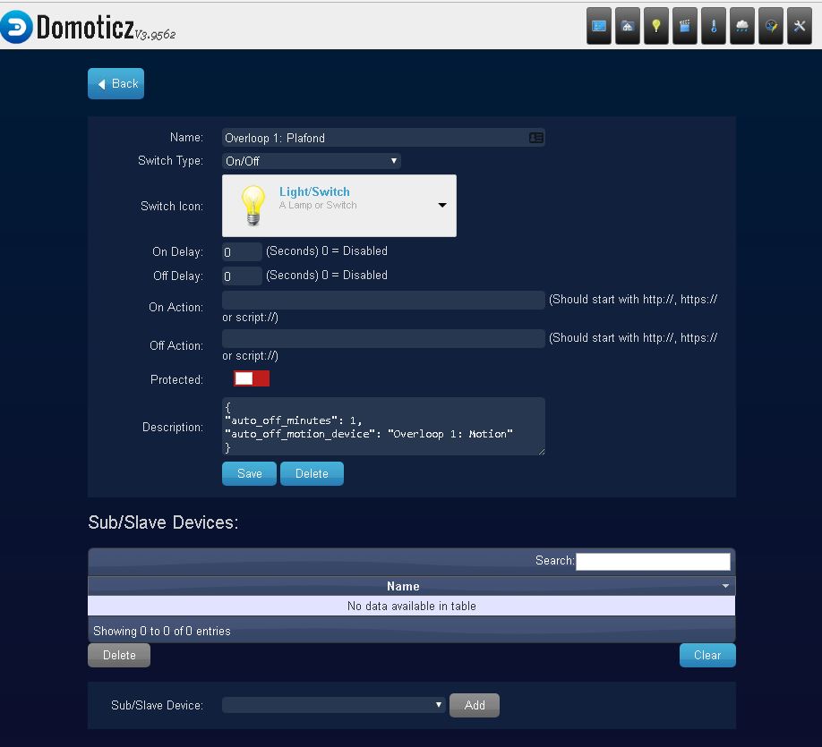

In my house I have multiple switches that are either manually or automatically by some mechanism switched on and that I want to switch off after some time. Initially I had a separate script for each such device. But the amount of scripts kept on growing and it was not very clear anymore which script controlled what switch and when I wanted to change a setting change or a add switch I had to go into the scripts and alter them. Rather tedious and error prone. So came up with a generic solution to specify per device if it was to switched off automatically and if so, after how much time. Once I had this working I added the possibility to delay switching the light off for as long as someone is still in the room, as detected by a motion detector (a PIR). I wanted my switches to be easy configurable, and I don't think having to go into a script and add, update or remove devices names or even index values is very easy. So I wrote a single script that is executed once a minute and checks all devices to see if it needs to be switched off. This script reads for each device a setting, stored in the devices' description field, to see what to do for this device. If a device's description does not contain the values, that device is not switched off automatically. If it contains only an "auto_off_minutes" value, the device will be switched off if its state = 'On' and its LastUpdate is older than the number of minutes specified in the value. If it contains also a value for "auto_off_motion_device" and the switch is on for at least the "auto_off_minutes" value, the motion device by the name specified is interrogated to see if is currently off and its last update is more than the amount in auto_off_minutes old. If the motion is indeed off with lastupdate being old, the switch is switched off. If the motion device is On or lastUpdate is less than auto_off_minutes old, there must still be someone in the room and the switch is not switched off.
Here's an example of what to put in a device's description field to make it switch off automatically after two minutes:
"auto_off_minutes": 2
And here's an example of how to make a switch go off 1 minute after the last person has left the room:
"auto_off_minutes": 1,
"auto_off_motion_device": "Overloop 1: Motion"
Another example to show how to use multiple motion sensors for a single light. If either of the sensors still shows activity, the light remains on (thanks @waaren!):
"auto_off_motion_device": ["Overloop 1: Motion 1", "Overloop 1: Motion 2"]
If I want to make a new switch go off automatically, I don't need to go into my scripts any more, I simply enter the proper values in the device's description field and it will use the new settings.

This script will run every minute and can automatically send an 'Off' command to turn off any device after
it has been on for some specified time. Each device can be individually configured by putting json coded
settings into the device's description field. The settings currently supported are:
- "auto_off_minutes" : <time in minutes>
- "auto_off_motion_device" : "<name of a motion detection device>"
If "auto_off_minutes" is not set, the device will never be turned off by this script. If
"auto_off_minutes" is set and <time in minutes> is a valid number, the device will be turned off when it
is found to be on plus the device's lastUpdate is at least <time in minutes> minutes old. This behavior
can be further modified by specifying a valid device name after "auto_off_motion_device". When a motion
device is specified and the device's lastUpdate is at least <time in minutes> old, the device will not
be turned off until the motion device is off and it's lastUpdate is also <time in minutes> old.
Specifying "auto_off_motion_device" without specifying "auto_off_minutes" does nothing.

I knew I am not the most talented person when it comes to scripting, but...
Would someone please be so kind to explain it is done in case of multiple motion sensors?
Followed the gives examples which resulted in errors:
2019-12-23 23:12:00.199 Error: dzVents: Error: (2.5.3) Error parsing json to LUA table: /home/pi/domoticz/scripts/dzVents/../lua/JSON.lua:1009: /home/pi/domoticz/scripts/dzVents/../lua/JSON.lua:660: expected colon at char 66 of: {
2019-12-23 23:12:00.199 "auto_off_minutes": 5,
2019-12-23 23:12:00.199 "auto_off_motion_device": {"PIRBadkamer", "XiaomiBadPIR"}
2019-12-23 23:12:00.199 }
2019-12-23 23:12:00.199 Error: dzVents: Error: (2.5.3) Device description for Bad ambiance spot 1 is not in json format. Ignoring this device.
I can't figure out te correct way (most probably quit obvious to others) to list multiple sensors...

Given that you have 2 motion sensors "Overloop: Motion 1" and "Overloop: Motion 2" and want your light to go off 5 minutes after the last motion was detected on either sensor, this would be the text you would need to put in your light's description field:
   "auto_off_motion_device": ["Overloop: Motion 1","Overloop: Motion 2"]
Rrozema's original post, the one he updates,a tiny detail is changed:
{ went to the gym and became [
"auto_off_motion_device": ["PIRBadkamer", "XiaomiBadPIR"]
No errors this time.
