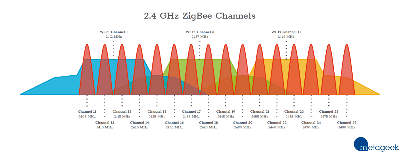

Are there mandatory channels in Zigbee standard? For example in Metageek's web page it says that "ZigBee channel 26 is usually relatively unaffected by WiFi, but many ZigBee devices do not support it." . Are there differences in US, Europe and Asia like in WiFi channels?
https://www.metageek.com/training/resou ... tence.html

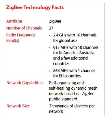

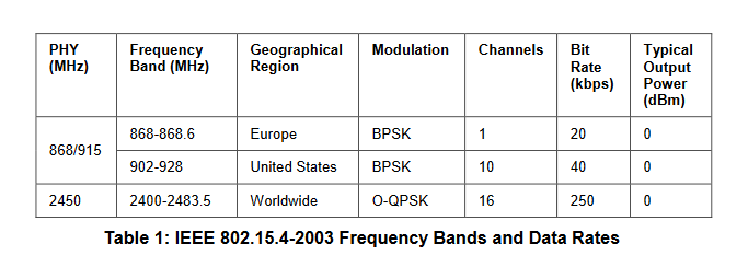

From https://www.trane.com/content/dam/Trane ... epaper.pdf and https://www.nxp.com/docs/en/application ... N-1079.pdf

Typical output power is 0 dBm. Zigate reports Signal Level and RSSI.
