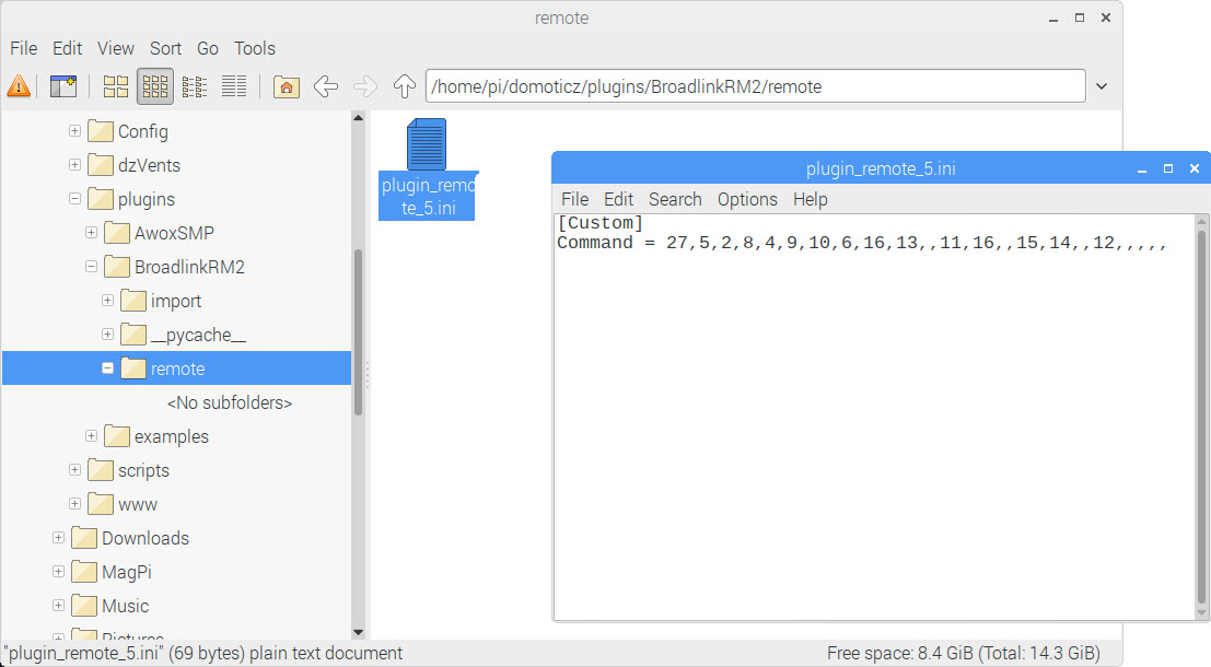

[Custom]
command = 27,5,2,8,4,9,10,6,16,13,,11,16,,15,14,,12,,,,,
I tried also with:
[Custom]
and:
[Custom]
Command = 27,5,2,8,4,9,10,6,16,13
There is a strange thing, in the guide and in the python file (plugin.py) it's written that the ini file for remote should be in remote folder (for me /home/pi/domoticz/plugins/BroadlinkRM2/log/remote) and his name should be plugin_remote_<<hardwareid>>.ini (so for me /home/pi/domoticz/plugins/BroadlinkRM2/log/remote/plugin_remote_5.ini).
But in fact, if I create the file and put it in the correct folder as shown in the guide, Domoticz tell me:
2019-04-15 17:32:24.419 Error: (Broadlink RM2 Soggiorno) ini file not found: /home/pi/domoticz/plugins/BroadlinkRM2/log/BroadlinkRM2-5-254.ini
So I renamed my file and placed it in the folder shown by the Domoticz log and it happens what I wrote in my previous post.
What I do wrong?
Thank you very much
[EDIT]
I create the ini file by copying one of the learned codes, so the format should be correct.
The character Coding is UTF-8

this file need to be under remote folder.
Verify that you put correct right on it.. just to validate, you can start with chmod 777

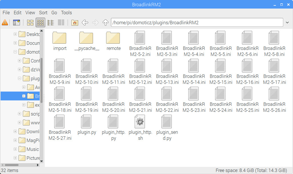

So as you can see Domoticz doesn't search on remote folder and the file name isn't plugin_remote_5.ini
Why does it happen to me?
You can find attached the folder structure

@arcpaqua
At one moment you said to have this error:
but I do not see any log folder on your screenshot....
put the plugin on debug mode.
and post Domoticz log from start.

2019-04-16 14:14:36.509 Error: (Broadlink RM2) 'onStart' failed 'MissingSectionHeaderError'.
2019-04-16 14:14:36.509 Error: (Broadlink RM2) ----> Line 218 in '/home/pi/domoticz/plugins/BroadlinkRM2/plugin.py', function onStart
2019-04-16 14:14:36.509 Error: (Broadlink RM2) ----> Line 978 in '/home/pi/domoticz/plugins/BroadlinkRM2/plugin.py', function genRemote
2019-04-16 14:14:36.509 Error: (Broadlink RM2) ----> Line 960 in '/home/pi/domoticz/plugins/BroadlinkRM2/plugin.py', function get_remoteconfig
2019-04-16 14:14:36.509 Error: (Broadlink RM2) ----> Line 698 in '/usr/lib/python3.5/configparser.py', function read
2019-04-16 14:14:36.509 Error: (Broadlink RM2) ----> Line 1077 in '/usr/lib/python3.5/configparser.py', function _read

2019-04-16 14:16:20.581 Status: User: Admin initiated a switch command (28/Broadlink RM2 - Remote/On)
2019-04-16 14:16:20.603 Error: (Broadlink RM2) ini file not found: /home/pi/domoticz/plugins/BroadlinkRM2/BroadlinkRM2-5-254.ini

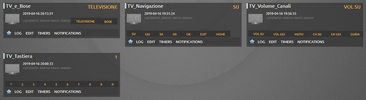

arcpaqua
Posts: 16
Joined: Saturday 23 June 2018 20:47
Domoticz version: 4.10338
Re: Python Plugin : Broadlink RM2 V4
Post by arcpaqua »
arcpaqua wrote: Tuesday 16 April 2019 15:26 I'm sorry @zak45
It's because I just made some experiment by changing folders.
The question is the same in both (with and without log folder).
Below the log with the following actions: reboot system, restart domoticz service, restart (update) hardware Broadlink and click on remote button switch.
For now, I solved with a little trick: I created 4 switch selector with all TV commands.
zak45
Posts: 954
Domoticz version: V2024.4
Post by zak45 »
@arcpaqua
Do you have verified right settings on your ini / folder ?
User running Domoticz need to have at minima read authorization.

Hello Zak45,
I'm posting in the right place then :)
When trying to launch it by command line i have the folowing:
File "plugin_http.sh", line 1
nohup python /Domoticz/plugins/BroadlinkRM2/plugin_http.py $1 $2 $3 &
SyntaxError: invalid syntax
Looking everywhere in this plugin but didn't figure out what went wrong...
How do I check port usage under debian? ( silly question but I'm more a windows guy :) )
Edit : somehow something changed ! the nohup.out now indicates :
python: can't open file '/Domoticz/plugins/BroadlinkRM2/plugin_http.py': [Errno 13] Permission denied
wheras before it was a path error saying that such file or directory did not exist.
zak45
Posts: 954
Post by zak45 »
Loky31 wrote: Thursday 02 May 2019 10:12 Hello Zak45,
fine :-)
verify when you do python from a terminal session that it load python v3.x and not 2.x.
If loading 2.x then replace python by python3 into plugin_http.sh
And yes, check again all rights on the file.
