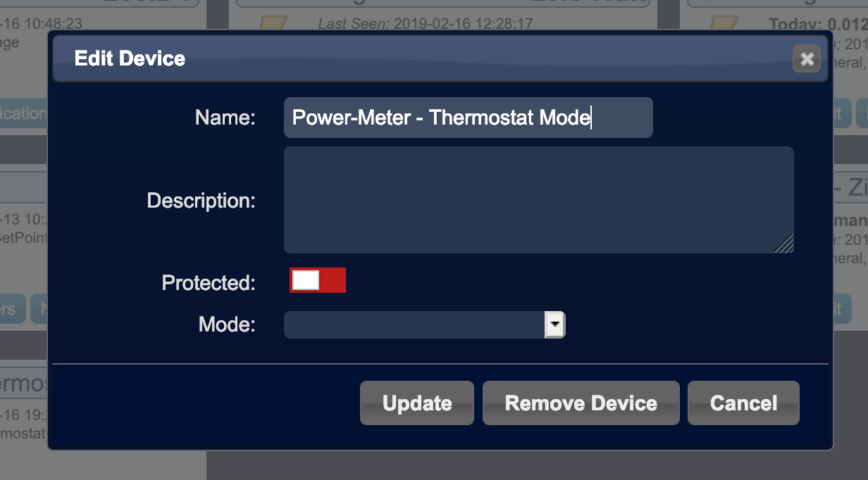

I want to create a Thermostat Mode widget inside a plugin, but I'm facing trouble to get/set Modes
Screenshot 2019-02-16 at 19.33.10.png (146.85 KiB) Viewed 1302 times
Here after is the code I'm using to create. However how can I add/define the Mode List ?
I had a look to an existing device created by OZW. I do not see any Mode define at that level !!!
