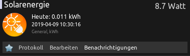

Thanks a lot, this almost worked out of the box. Great way also to learn something, especially how you managed to get the nearest time. Great work!
I just decided to finally use a sensor of type: "Electric (Instant+Counter)" and modified the script to update the sensor via the JSON API, because also I want to send the data to an InfluxDB. The sensor calculates the daily energy himself and I even get a nice Icon :D
Bildschirmfoto von 2019-04-09 10-33-09.png (12.96 KiB) Viewed 2420 times
So, I'm very happy now 8-)
