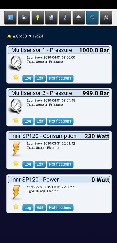

one week ago I installed my first smart home setup - conbee usb plug, deCONZ, Domoticz and Domoticz-deCONZ plugin. Aquara weather sensor and smart plug innr SP 120 work very well, but I receive in Domoticz wrong measurement units:
pressure (Aquara); Bar instead of hPa
Power consumption (innr): Watt instead of Watt hours (better convert to kWh *0.001)
Sorry, an important correction:
Innr Smart Plug send state.current [mA], not state.power [W]. This value must be converted (*230*0,001=W) -> look here: https://github.com/dresden-elektronik/d ... wer-meters
How can I change it?
Thanks in advance.
Cavediver

- Screenshot.jpg (61.48 KiB) Viewed 1729 times

Oups sorry, I haven't see your issue. The official topic is here https://www.domoticz.com/forum/viewtopi ... 68&t=25631
I m on it ATM, I will answer on the github issue, (This one, I have see it ^^)

Thank you for your answer. I'm already in touch with Smanar to fix it in the Domoticz-deCONZ plugin (https://github.com/Smanar/Domoticz-deCONZ/issues/13). We are nearly finished.
