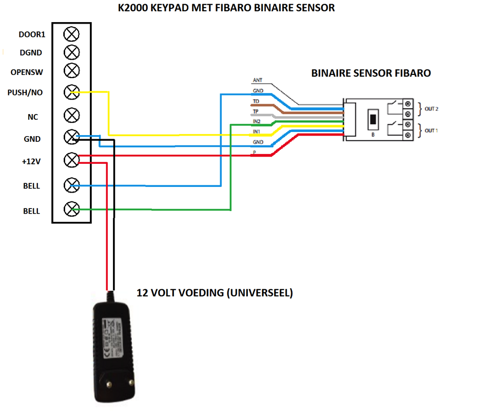

I've bought a K2000 security keypad. I've seen that I can link this keypad to a fibaro binair sensor. I was wondering if I its possible to link this keypad to a wemos D1 with ESP easy instead of a fibaro sensor. This is a working connection diagram to a fibaro sensor:

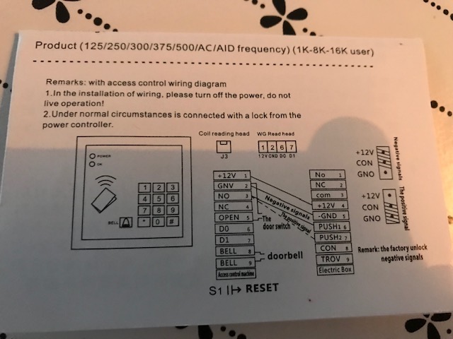

This is the diagram of the K2000 panel:
I only want to switch my alarmsysteem (in domoticz) on or off. I do not want to pair with a doorbell or doorlock. If it's possible how do I connect this? Do I need a (dual)relayboard? Which contacts of the K2000 do I need? In the fibarodiagram I see the only use 3 contacts beside power/ground If I have to use a dualrelayboard I need 4 contacts I should think.
I don't want to damage my panel so somekind of hardwareconnectionstips are welcome.

The system is with 12V so I think I have to use first a buckconverter to convert 12V tot 3,3V for the GPIO's of the Wemos? Someone?

I am now further. I connect the two "BEL' contacts to Ground and GPIO12. With this switchinput I want to set my alarm ' IN'.This works fine.
The contact NO (normally in)/push on the panel I've connected to GPIO13.With this switchinput I want to set my alarm 'OUT'.

Re: K2000 keypad
You would need a level shifter to connect it to the GPIO's of the ESP.
If I see it correctly, the pins 1,2,6 and 7 have the name WG on top of it. It is Wiegand, standard supported by ESPEASY SW.
you can use that to send the data from the keypad to a text sensor in DZ and work from there with the data.
Doing it with a wiegand interface from a RFID reader for many years already without any issues (also 12V).
