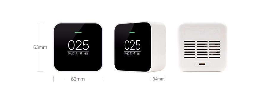

Hi again,
This is the device:
And this is the devices page: Now that i realized, i have to use a custom device for this, because this is ppm, whereas PM2.5 is micrometers/something. And so comments doesn't fit like excellent, good bad etc.
This is the device:
