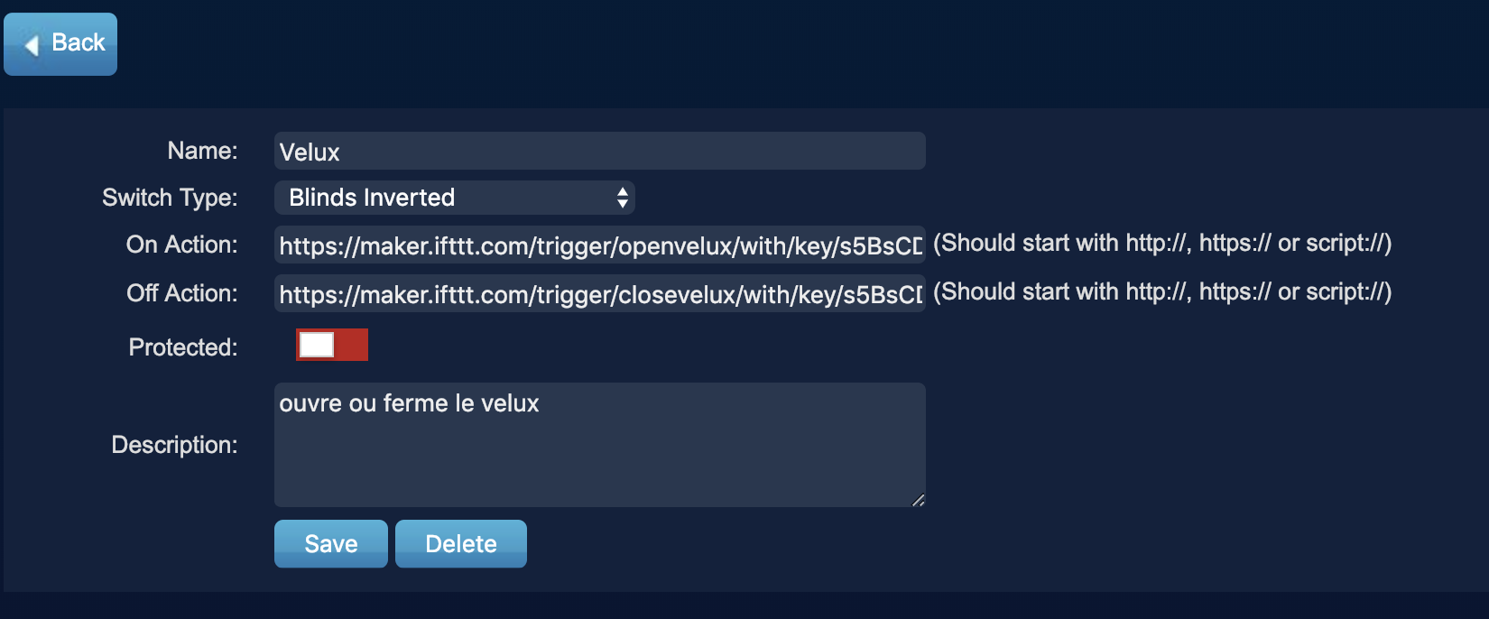

Hi there!
I'm quite new to domoticz and I have a Somfy Tahoma.
i just want to say you can control your tahoma with Domoticz using IFTTT.
On IFTTT you search for tahoma service and you link your account.
On IFTTT you create a new applet :
- IF "webhook" (enter the name of the event , something like 'open_velux")
- THEN launch scenario on Tahoma, and select the scenario you already have. If not, go and create some scenarios and come back here)
In domoticz, you add a new Hardware via setup menu. You choose "Dummy (Does nothing, use for virtual switches only)"
Then you edit the button, and select switch type : "Blinds" or "Blinds inverted"
On action : https://maker.ifttt.com/trigger/{event} ... BsCD8Kxwn4....
Off action : https://maker.ifttt.com/trigger/{event} ... BsCD8Kxwn4....
You have to do that for each blinds
Hope it helps
Hope it helps
