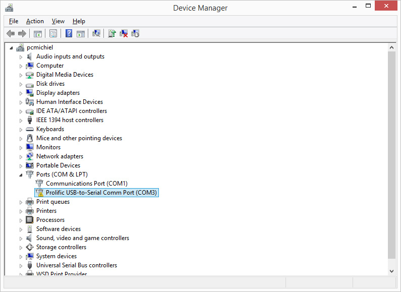

I srsly dont get it, how do you connect it with USB by using opentherm monitor tool? under connect i see only COM1 and TCP Connection.
When i plug in the USB in the pc it says installing device, but when i choose COM1 in connection again nothing happens, and there is no COM3 to select like in the attachment below.
If i now try the firmware upgrade it says once again, please manually reset the opentherm gateway, i unplug the power cord, and put it back in (5 secs later), still nothing: Could not switch gateway to self programming mode.
Niks anders dan problemen met dit ding helaas :(

tcviper wrote:I srsly dont get it, how do you connect it with USB by using opentherm monitor tool? under connect i see only COM1 and TCP Connection.
Zie in Windows bij hardware ook dit als ik usb inprik:
Mmm
- Remove all Com ports from windows device manager
- Restart computer
- Check available COM ports
- Plugin OTGW via USB
- See what Comport is added. If none you have to install the driver.
- Start OTMonitor
- Connect via the new Comport.
- Do you now actually receive data?
- If so flashing should be possible exactly as you described FLASH, remove power cord, attach power cord.
http://otgw.tclcode.com/otmonitor.html#upgrade
http://otgw.tclcode.com/download.html
If no COM port is added we might have to download some additional drivers.

Tried what you suggested, removed all com ports in Windows, then restart... again the same Prolific USB-to-serial thing shows up under devices when i plug in the otgw.
There is no driver on the otmonitor page, out of ideas here. What is also strange if you ask me is that it shows up with and without pluggin in the 230v power.
Under hardware properties of this COM3 device i see:
This device cannot start. (Code 10)
A device which does not exist was specified.
Update, for those running windows 8.1 and have same problem, try this:
http://answers.microsoft.com/en-us/wind ... 34f8137645
I got the device working now i see over 22 devices in Domoticz all for opentherm gateway. How can i now best add all this and make domoticz a thermostat so it does things when for example temperature goes below xx?

tcviper wrote:Tried what you suggested, removed all com ports in Windows, then restart... again the same Prolific USB-to-serial thing shows up under devices when i plug in the otgw.
Great you got it working. :D
Driver including Windows 8 warning
http://www.prolific.com.tw/US/ShowProdu ... 25&pcid=41
Windows 8/8.1 are NOT supported in PL-2303HXA and PL-2303X EOL chip versions
