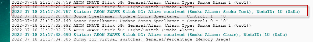

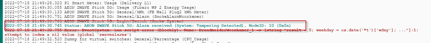

although the last post on this topic is already some time ago, I have a question:
I have also Fireangel wst-630 with ZWAVE module. I see 4 devices in domoticz: 3 switches and 1 Alarm. In Domoticz the smoke alarm is put to ON when I press the Test button on the module. Also when there is realy smoke detected the smoke alarm in Domoticz is put to ON. So from that point of view I can't see whether it is a test alarm or a real alarm. However, luckily in the log of domoticz, a message is shown on my AEOTEC Zwave stick, that it concerned a test (in the first case) and a real smoke alarm in the second case.
My question, can I somehow extract this information? I searched a lot of different forums, goolge etc...but couldn't find an answer.
I would like to build a script that notifies me in case of a specific alarm (test/real/tamper...) and not a general notification based on the status ON.
