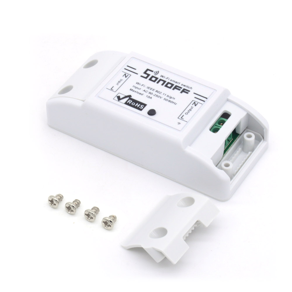

Is there a simple Zigbee relay module avalable like the Sonoff (but Wifi).
