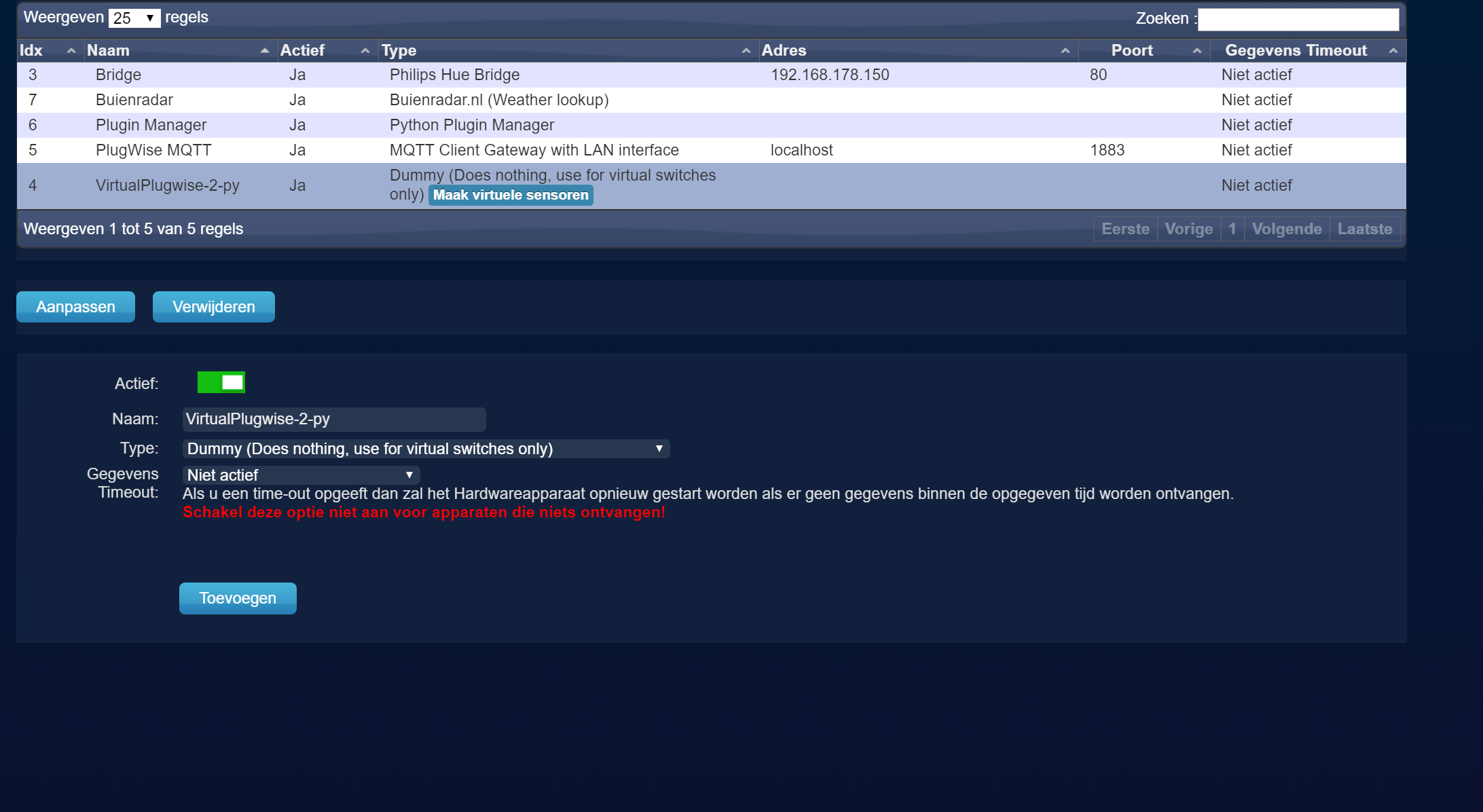

uibeltje wrote: Monday 03 September 2018 23:35 I am stuck at this moment connecting my plugwise circles to Domoticz.
Everything seems to work fine except the connection between node-red and Domoticz. I do see data in the data-log folder but fail to import it in Domoticz via node-red.
I have created the Virtualplugwise-2-py hardware and entered the idx in node-red but the circles don't pop-up in the list.
Does anybody know where to look for errors? Is there a node-red logfile? My experience with the command line is limited but I learn by trial and error.

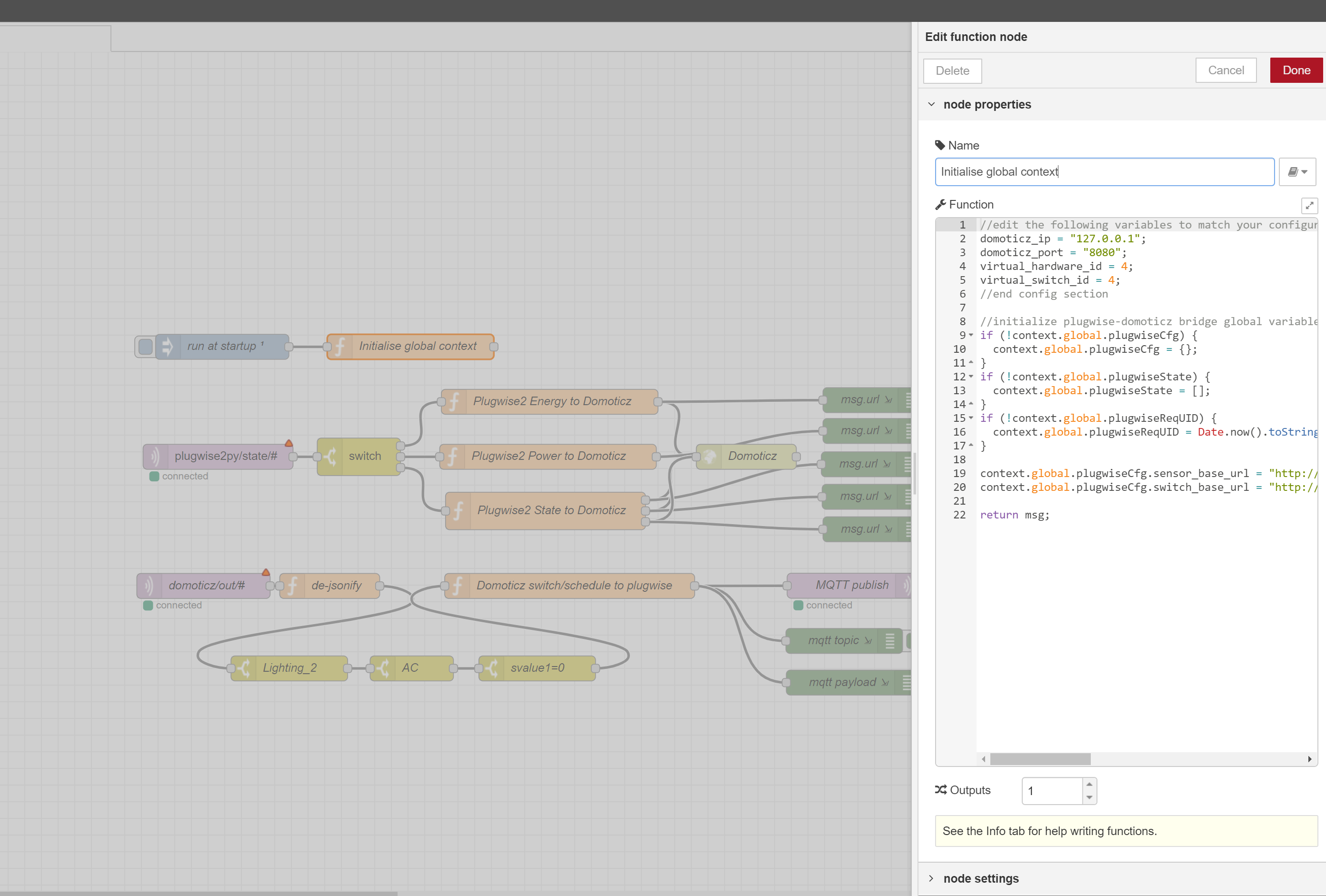

Hi all, this maybe be an old discussion but nevertheless I'd appreciate some help. I have the same problem as a couple of posters here, namely that the Circles do not appear in Domoticz after deploying the node-red script. I'm using the latest version of Domoticz, 4.10717. I tested that MQTT data appears in Domoticz. Node-red seems to be happily doing its thing - console messages indicate that data is being transferred to Domoticz. The Plugwise-2-py webpage shows data. I have dummy hardware configured, as one of the posters above shows in his screen shot. I updated the node-red script to reflect the hardware ID. So I've run out of ideas why the circles do not appear.
Help would be greatly appreciate!

hello, i have the same problem. i have 1 pi with plugwise2py all works fine. and a 2nd pi with domoticz, mqtt and node-red.
in node-red virtual div adjusted to correct id. but no devices in domoticz. Help !!

In the Node-Red flow under "Plugwise2 Energy to Domoticz" and "Plugwise2 Power to Domoticz" and "Plugwise2 State to Domoticz" it uses the format:
json.htm?type=command&param=udevice&hid=$HID&did=$DID&dunit=$DUNIT&dtype=$DTYPE&dsubtype=$DSUBTYPE&nvalue=$NVALUE&svalue=$SVALUE
to communicate with Domoticz and this results in ERR.
Apparently this string format is no longer correct (outdated?).
Can't find any reference to "did", "dunit", "dtype" and "dsubtype" on https://www.domoticz.com/wiki/Domoticz_API/JSON_URL's
Trying to figure out what to adapt...
