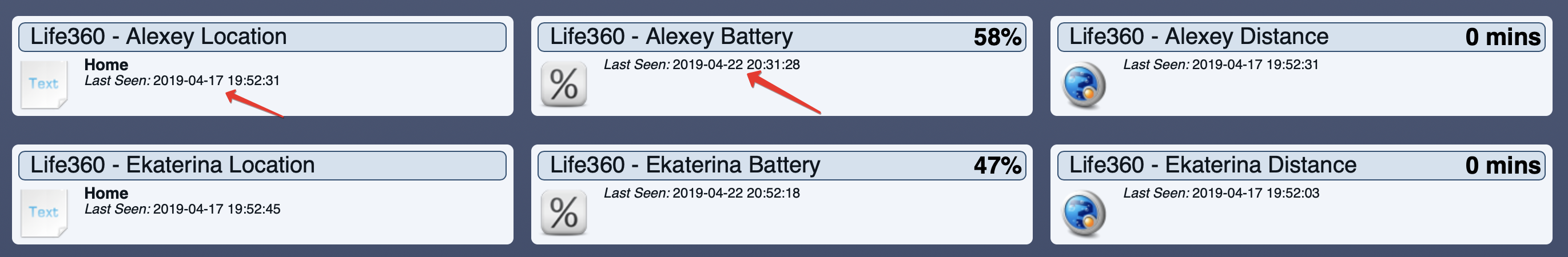

A few days ago, for some reason, the plugin stopped working normally. Apparently, after the update.
In the error logs (constantly repeated):
2019-04-22 21:21:34.527 Error: (Life360) 'onHeartbeat' failed 'ValueError':''Alexey' is not in list'.
2019-04-22 21:21:34.527 Error: (Life360) ----> Line 294 in /home/ustas/domoticz/plugins/Life360/plugin.py, function onHeartbeat
2019-04-22 21:21:34.527 Error: (Life360) ----> Line 182 in /home/ustas/domoticz/plugins/Life360/plugin.py, function onHeartbeat
immediately after launch:
2019-04-23 13:24:55.853 Error: (Life360) 'onStart' failed 'FileNotFoundError'.
2019-04-23 13:24:55.853 Error: (Life360) ----> Line 266 in /home/ustas/domoticz/plugins/Life360/plugin.py, function onStart
2019-04-23 13:24:55.853 Error: (Life360) ----> Line 105 in /home/ustas/domoticz/plugins/Life360/plugin.py, function onStart
Sometimes updated information about the battery level.
Domoticz - 4.9701
Python - 3.5.2
Life 360 Presence Detection - v2.3.1
