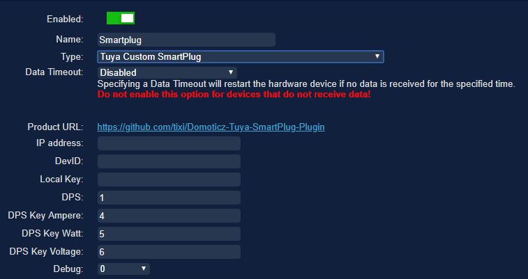

Some ideas for the KWh:
- you can create a virtual device and then update it with the json api with a curl command
- This command should be inserted in line 425
- To get the needed information state['5'] should work (you may have to divide the value)
5 here correspond to the dps entry 5, depending on your device the value may be different.

tixi7 wrote: Saturday 23 February 2019 23:50 Some ideas for the KWh:
The information is in state indeed. :lol:
Why not create those additional devices from within the plugin as well just as with the "Switch" when defining a plug?
something like:
	Domoticz.Device(Name="Tuya SmartPlug Switch #" + str(val), Unit=val, TypeName="Switch",Image=8).Create()
	Domoticz.Device(Name="Tuya SmartPlug Voltage #" + str(val), Unit=val, TypeName="Voltage").Create()
	Domoticz.Device(Name="Tuya SmartPlug Ampere #" + str(val), Unit=val, TypeName="Current/Ampere").Create()
	Domoticz.Device(Name="Tuya SmartPlug Usage#" + str(val), Unit=val, TypeName="Usage").Create()
	Domoticz.Log("Tuya SmartPlug Device #" + str(val) +" created.")
And then fill them without using an external json api curl.. call ?

dorenberg wrote: Monday 25 February 2019 10:41 If I need to send over the plug to someone for testing purposes, let me know. That will make life much easier. (Based in The Netherlands)
If you do a sudo python3 get_dps.py what is the output of the plug ?
I'm curious about the output.
This is mine.
Plug State Information:
{'dps': {'2': 0, '4': 243, '6': 2392, '5': 42, '1': True}, 'devId': '00621010cc50e3c3d408'}
Then we can see of the DPS is the same.
{'devId': '12716401807d3a7b5c6b', 'dps': {'6': '00ff0000000000', '4': 255, '106' : 2272, '101': True, '1': True, '2': 'colour', '10': 'ffff0505ff000000ff00ffff00 ff00ff0000ff000000', '7': 'ffff500100ff00', '104': 0, '9': 'ffff5001ff0000', '8' : 'ffff8003ff000000ff000000ff000000000000000000', '3': 180, '5': '171918009c1919 ', '105': 0}}
This is the output. So 104 105 and 106

Based upon the info provided by @jslegers (he has 2 different types of plugs) the following data can be retrieved and keys seem consistent.
Next step would be to create the appropriate devices and have the plugin push the data to them.
At least the ordinary plugs should then be working.

Maybe these dps values for the power consumption and voltage can be set as input boxes in the plugin?
sincze
Posts: 1302
Domoticz version: 2024.4
Re: [REQUEST] Plugin for Tuya
Post by sincze »
dorenberg wrote: Tuesday 26 February 2019 13:07 Maybe these dps values for the power consumption and voltage can be set as input boxes in the plugin?
You mean something like this:
Pass2php
USB: RFXCom, ZWave, Sonoff 3
MQTT: ZIgbee2MQTT,
ZWAVE: Zwave-JS-UI
Solar: Omnik, PVOutput
Sensors: You name it I got 1.

Post by dorenberg »
exactly what I meant!! Nearly there!
